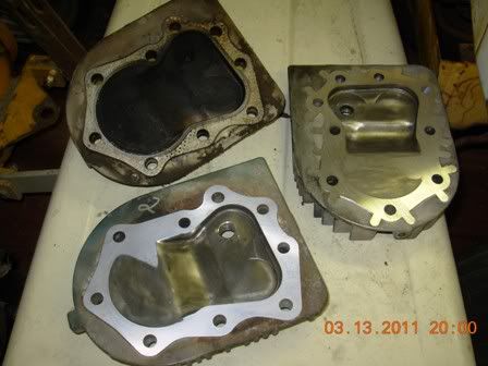

K301 old head on top. Head with #2 is now on the K301. Head on right is going on the K321.

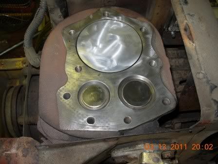

Block top after cleaning.

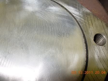

Piston top, lot's more life in this engine

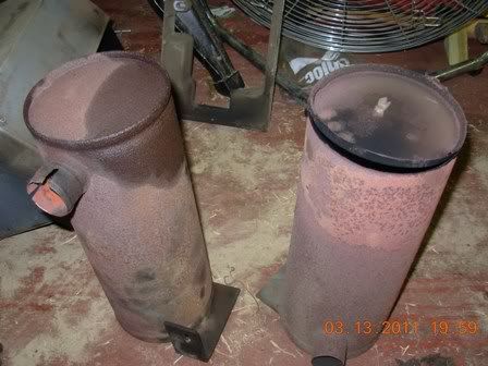

The mufflers

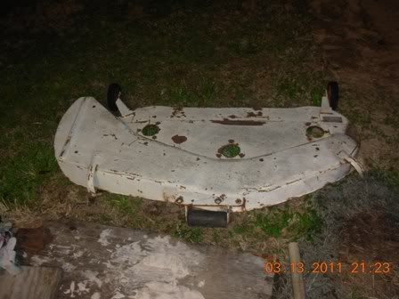

And a little score this weekend. A stripped 44" deck to replace my rust bucket

Those heads look great!

Those heads do look nice!!

What did you use to clean up the block, piston, and valves? Looks brand new!

Brake clean, pocket screwdriver, wire brush and a 3M fiber wheel and my die grinder. Looks kinda like a green scrubby pad.

I remember using them as an automotive tech years ago. We called them Scotch-Loc's. Thanks for the info Battlewagon!
