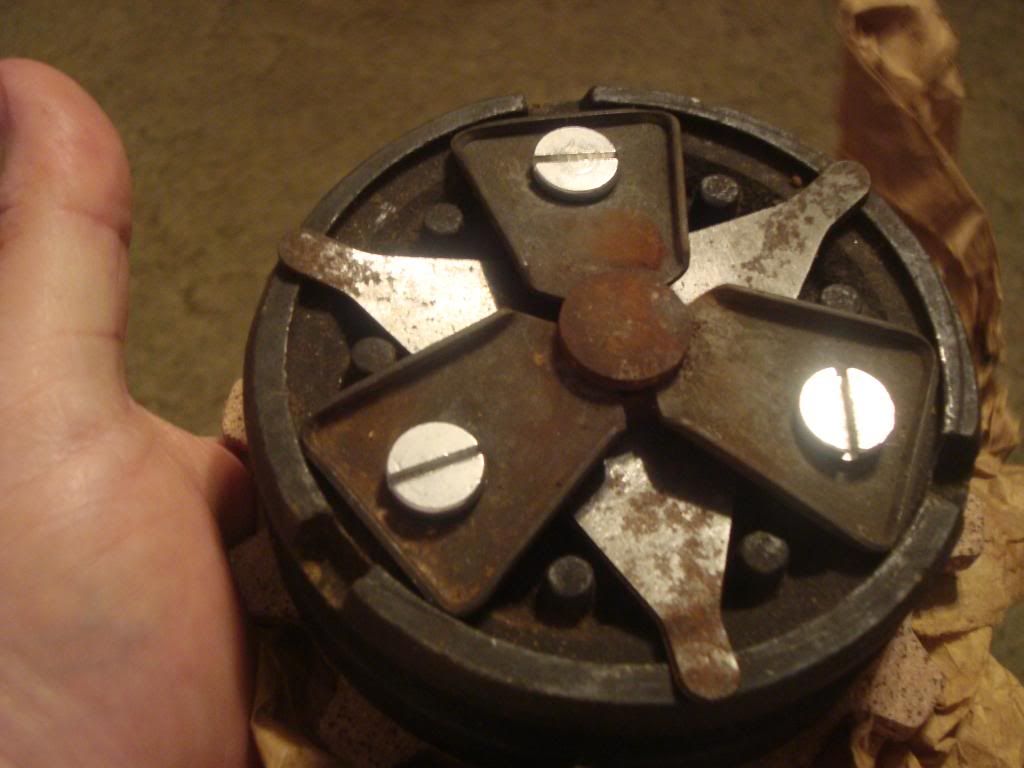

Here is a pic of a wide frame PTO for my 128. It has double springs.

I realize the different styles of ptos. My question is whether or not the double spring wide frame pto will work with the rock shaft on my 127 or should I just install one spring. The reason I ask is because I ordered the rebuild kit for the wide frame style before realizing my dilemma.
Old 02-28-2013, 06:51 PM
Posts: 11,210
As long as your pto looks like the one pictured above you should be fine.By the way you rockshaft has nothing to do with the pto.

As long as you use the correct spring/s for the PTO you should be alright.
For the rockshaft issue... The added pressure from the Wide Frame double spring PTO on a Narrow Frame rockshaft should not be any kind of issue, the rockshafts are pretty strong and I don't think one WF spring is quite as strong as one NF spring, so I don't believe you are actually doubling the pressure against the rockshaft.

I don't think I would use Wide Frame springs in a Narrow Frame PTO.
The NF PTO doesn't have the little "nubs" to keep the spring from turning in the casting.
