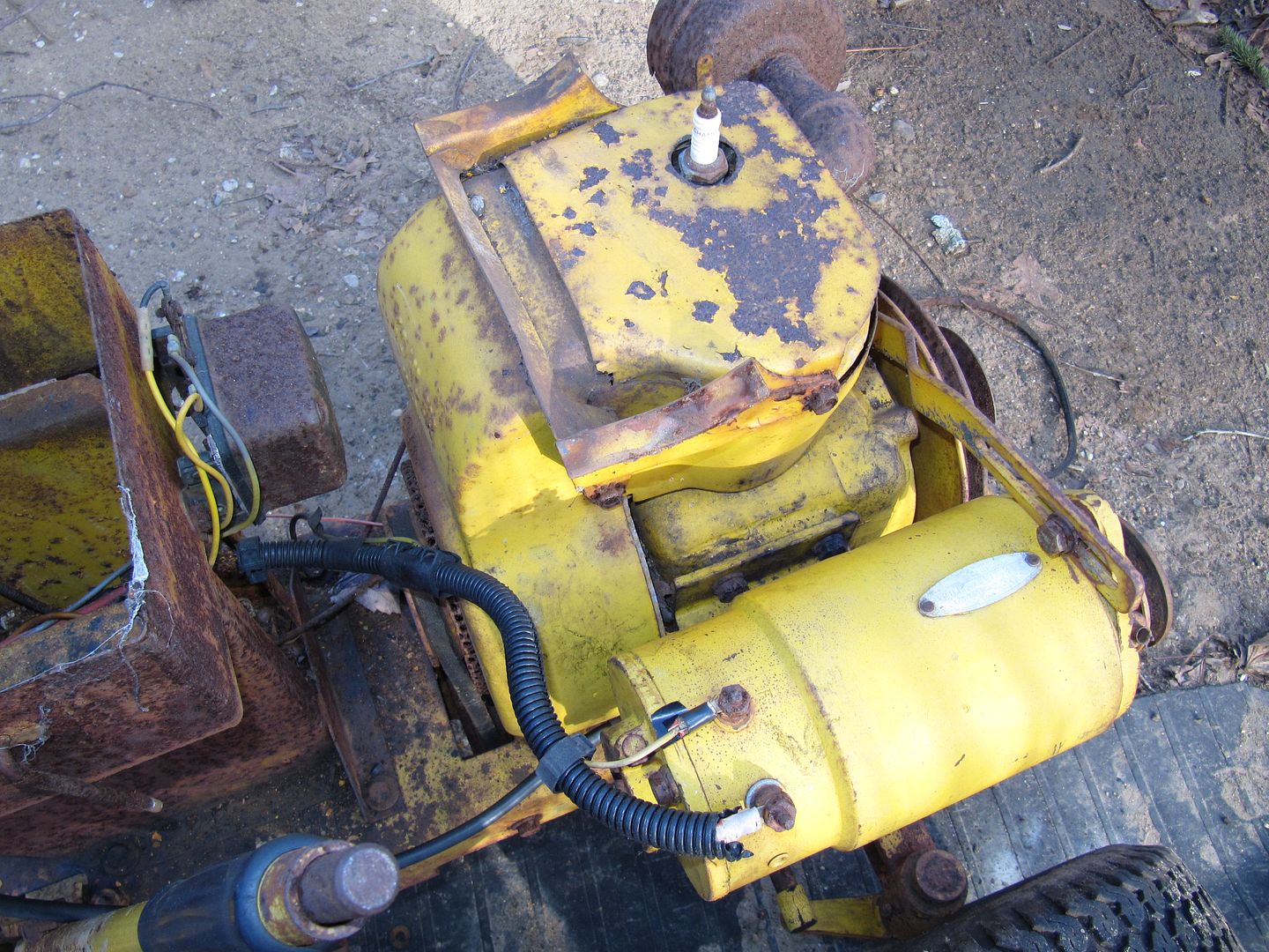

Nice find on the O. Nice to save another one from the "woods". You can tell she's been sitting for a while. Tires are sunk some. Otherwise, looks to be a great candidate for a worker or trailer queen. Congrats!

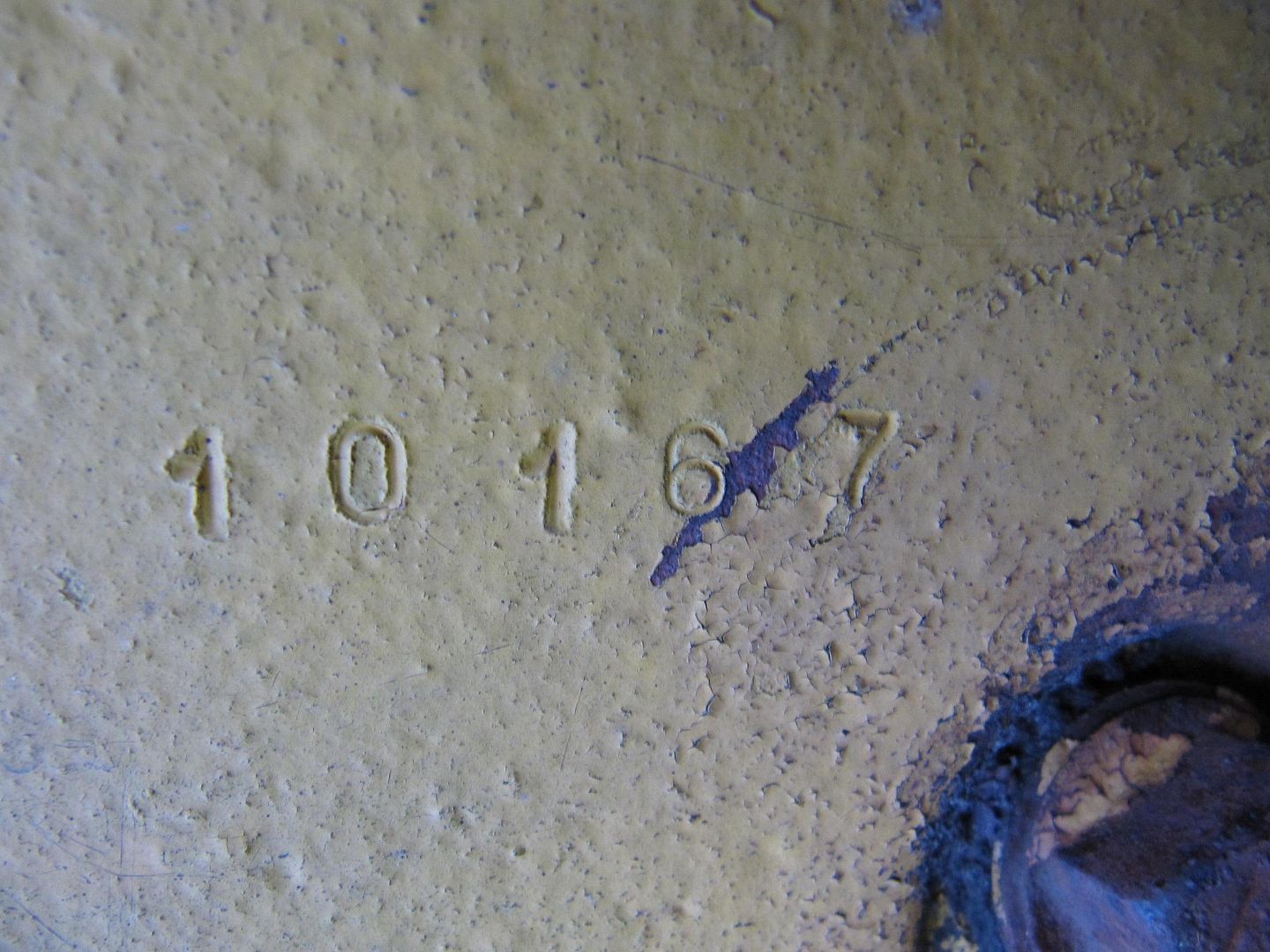

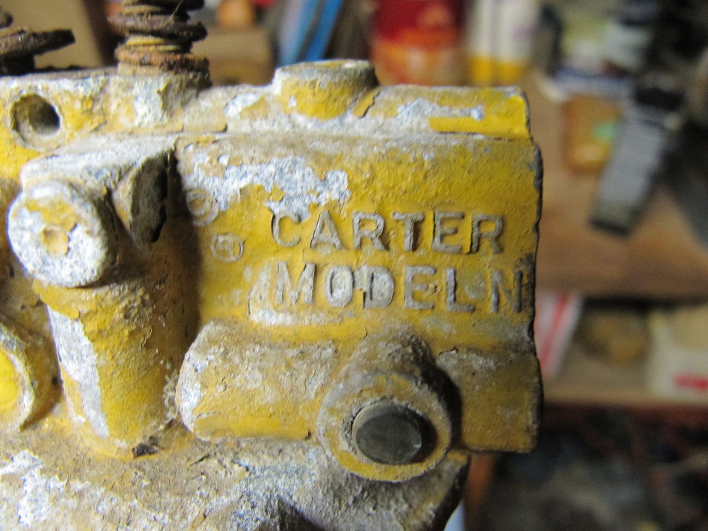

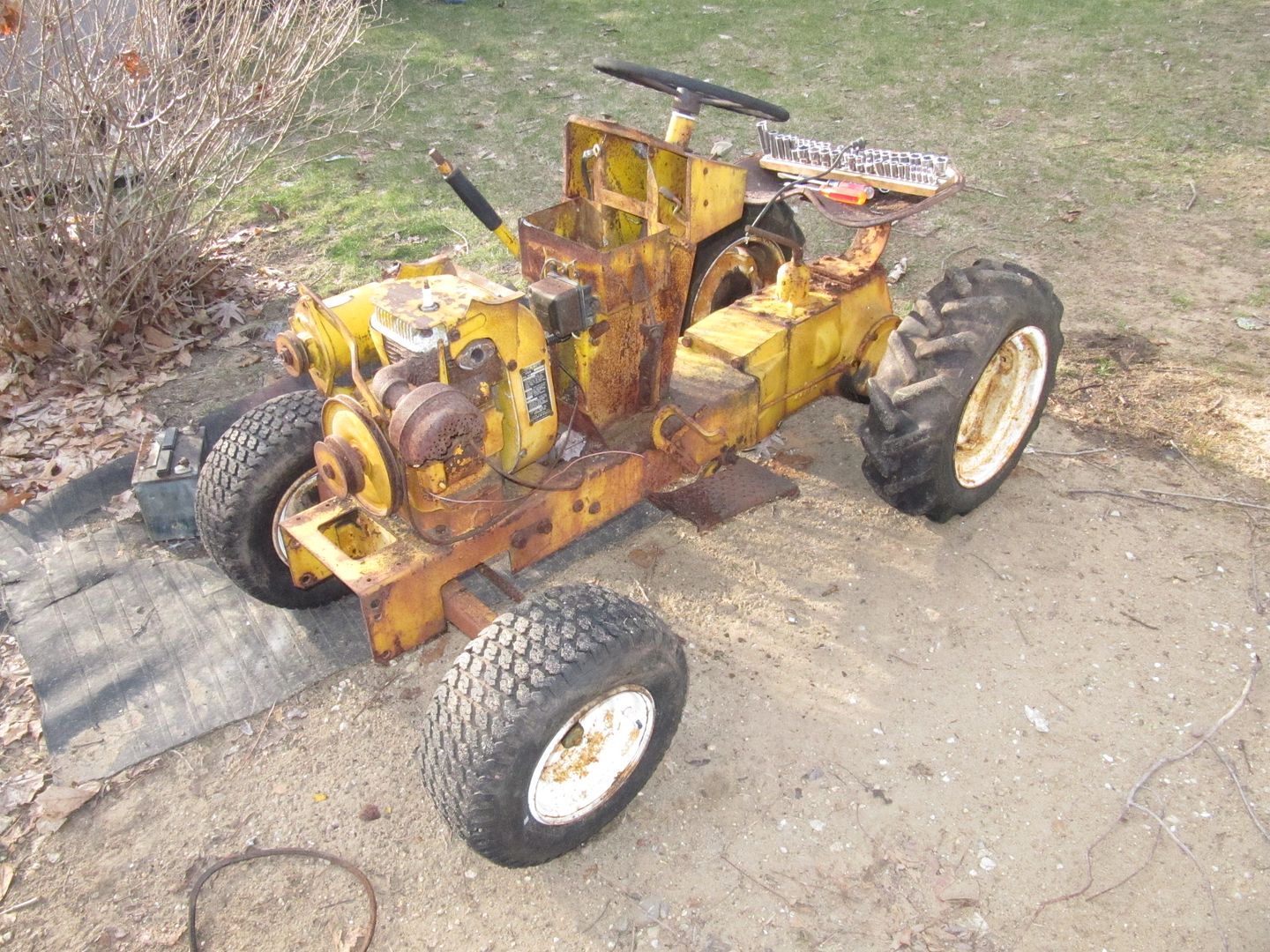

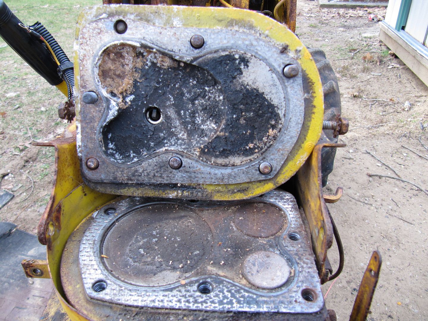

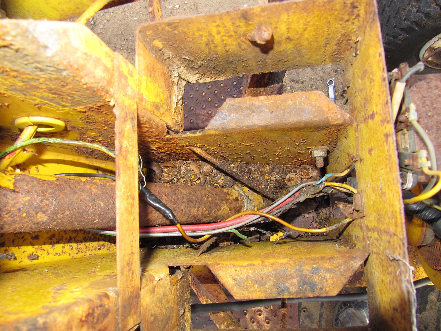

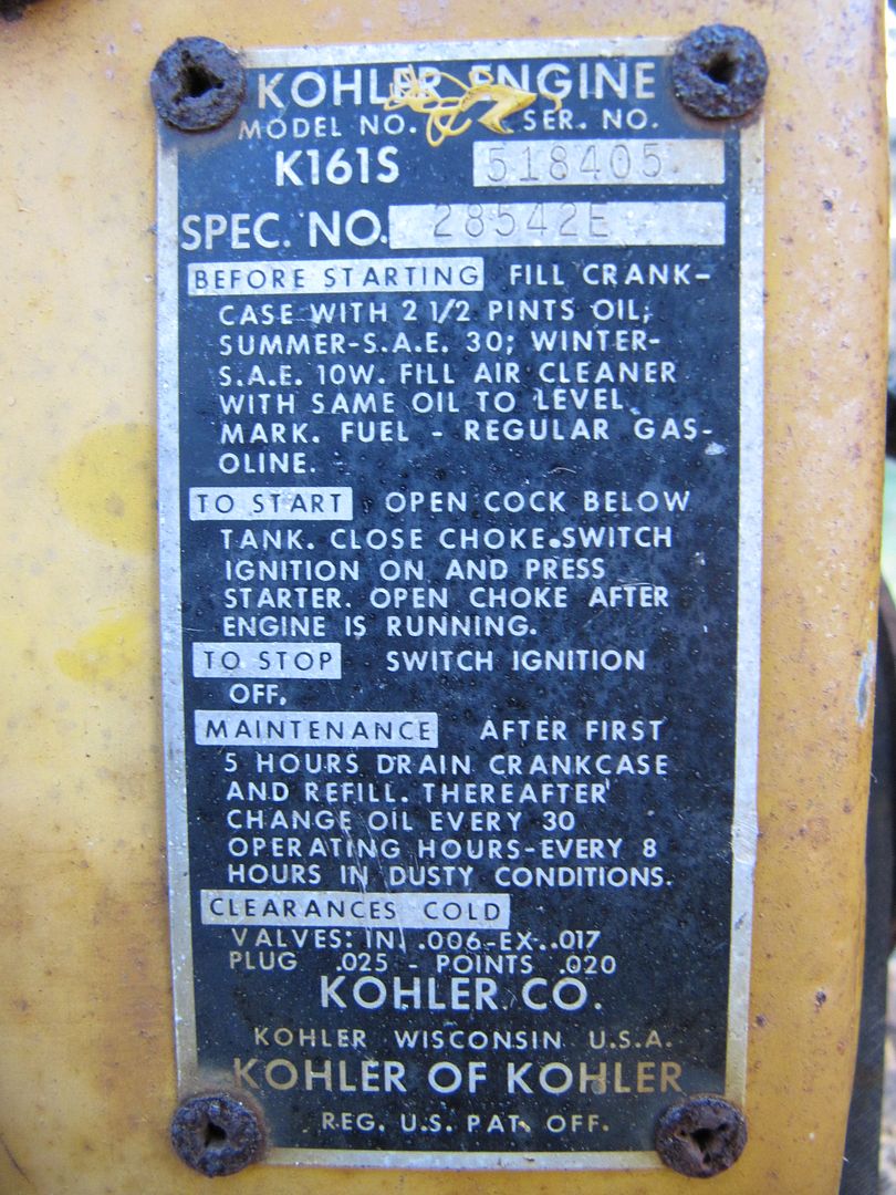

Some Pictures

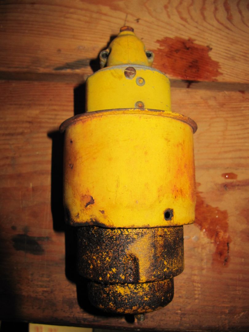

Anyone seen an oil bath like that? With a wing nut on the bottom and not a wire bail?
