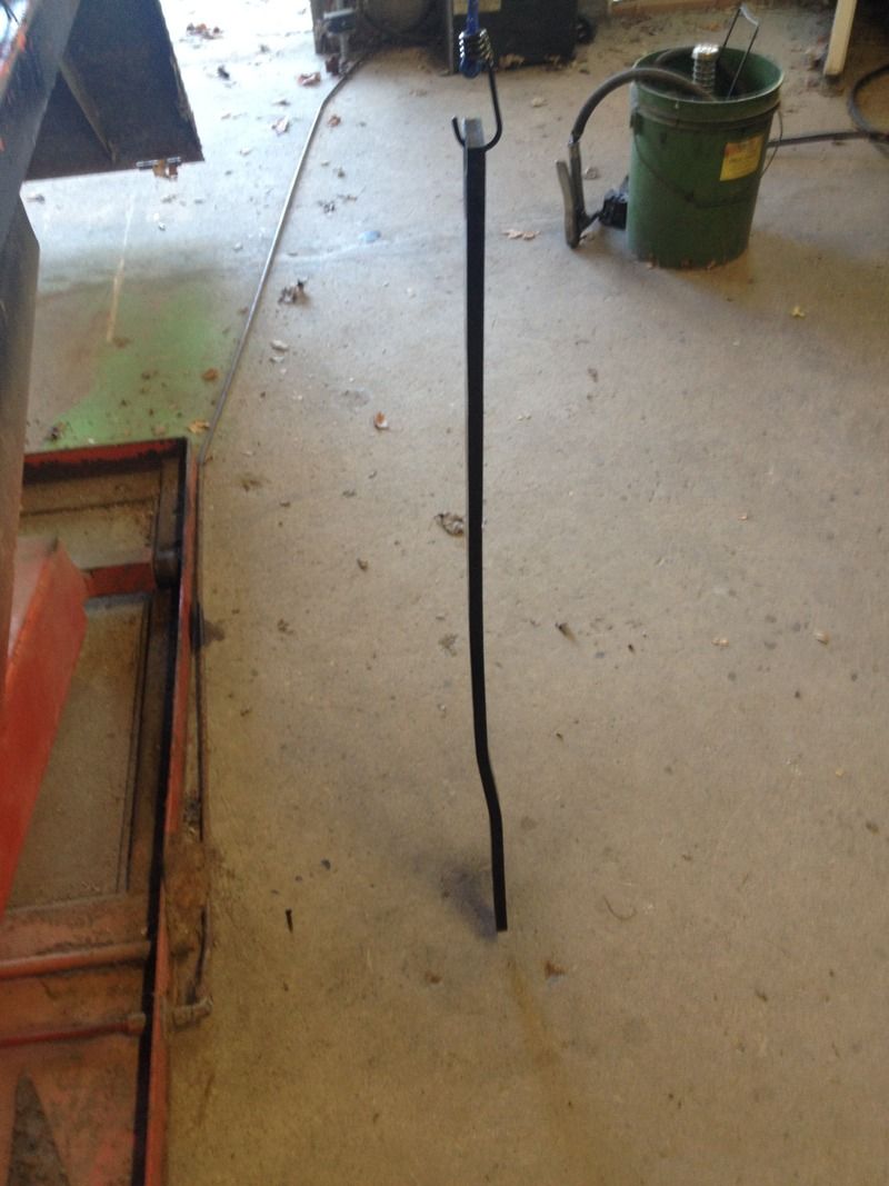

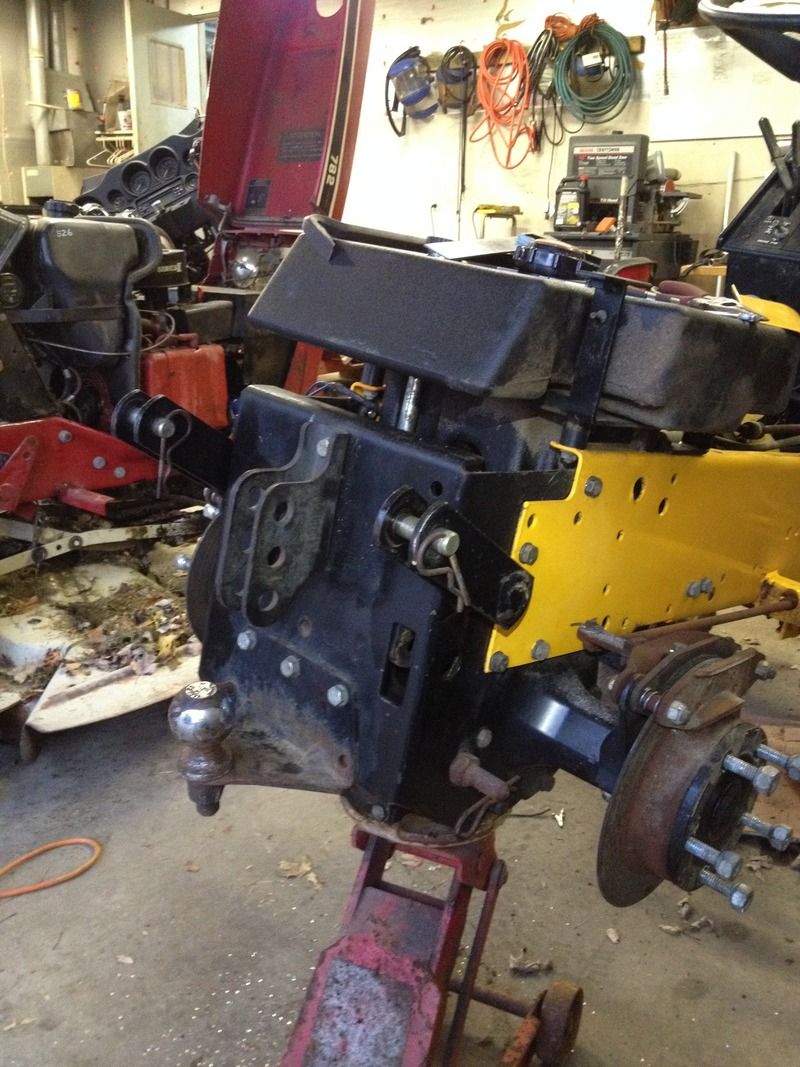

Got the three point moved from the 782, to the 1772. Of the (7) bolts that held it to the 782, only (3) lined up on the 1772. Had to drill (4) new holes in the frame of the 1772.
Lift bar appears to be 5.5 " too short.

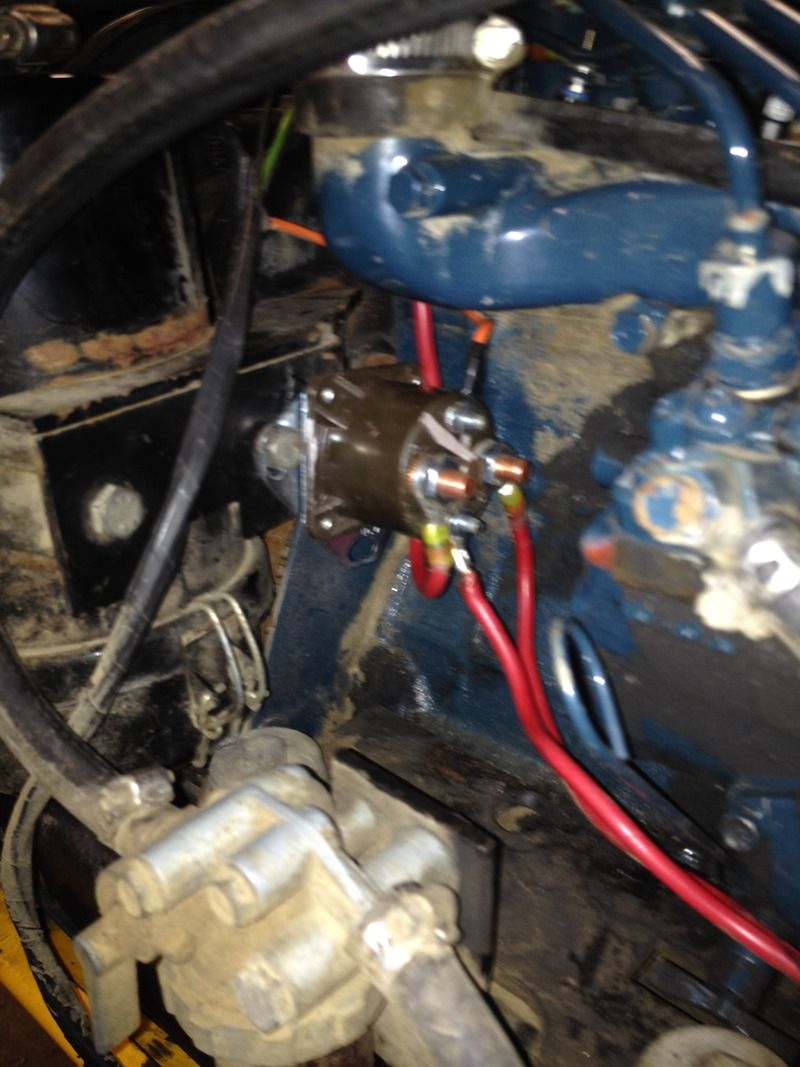

Finished up the solenoid

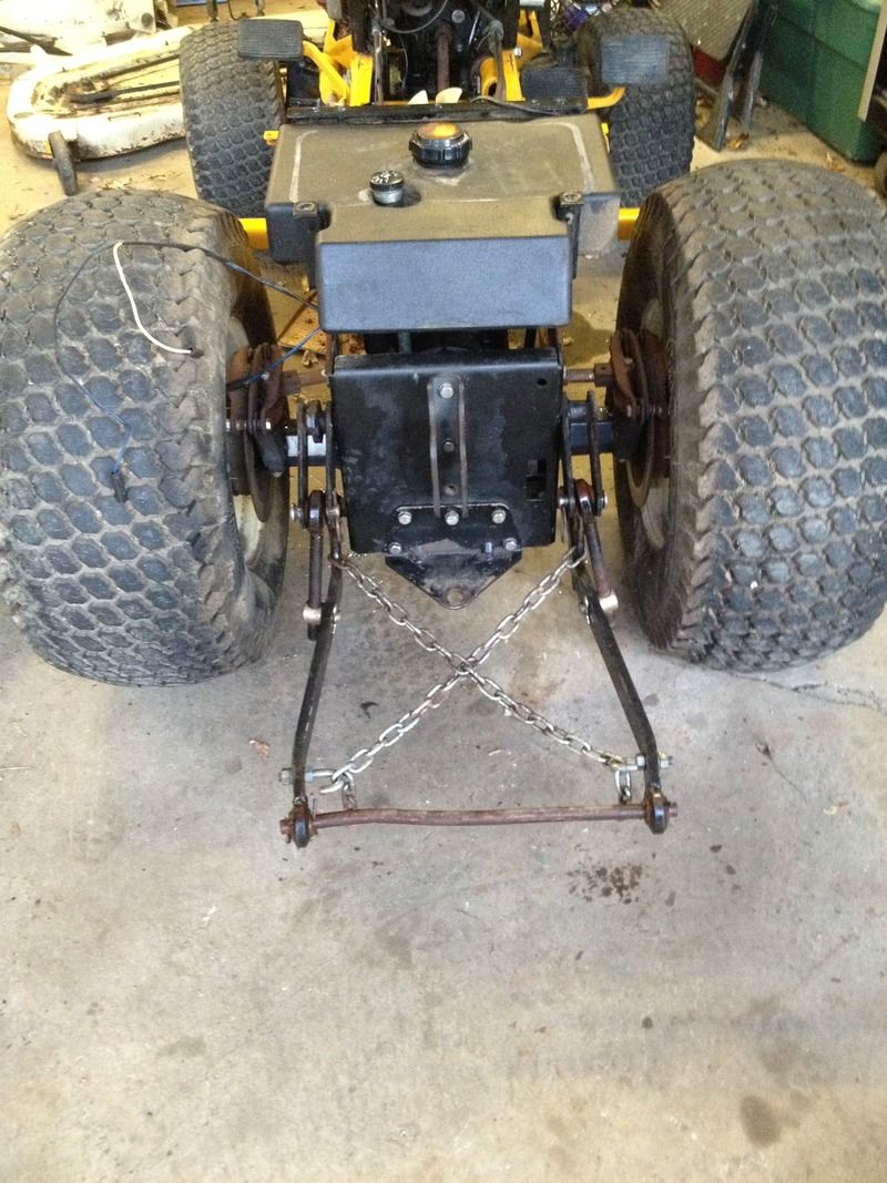

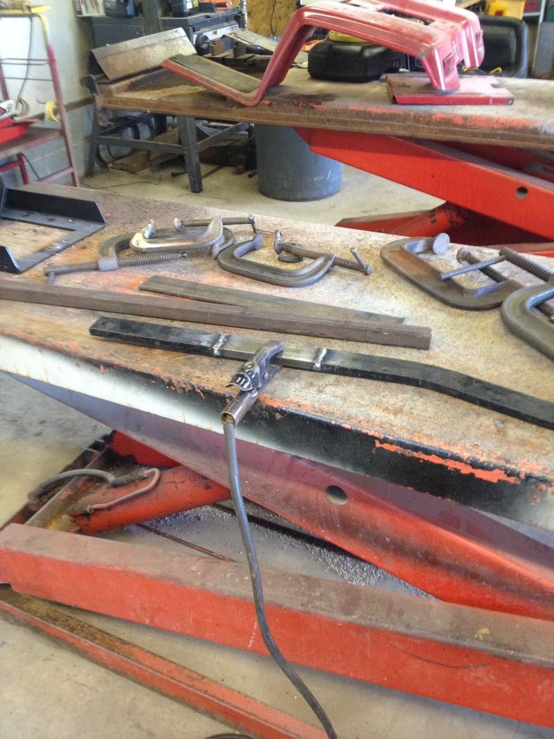

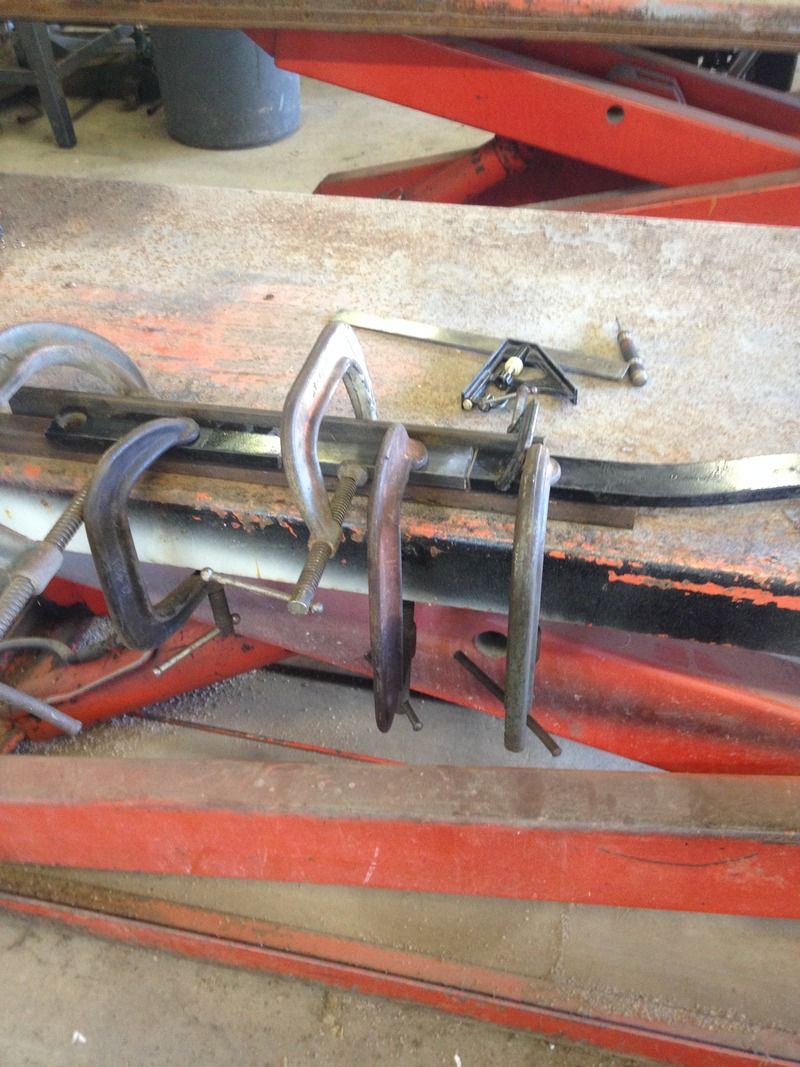

Cut the lift bar and welded in a 5.75" extension;
Then assembled the 3pt. I never had the arms on the 782, So It may not be exactly right;

Your lift links that run down from the rockshaft are on the wrong side of the lower arms. They attach on the inside.
There is more than the length of the lift bar and the absence of holes that is different between the two hitches (GT and SGT). The GT will work as you have found out, but it isn't as heavy built.
I actually switched those after I took that picture. That crossbar is bent, and one of the lower attach pins are bent. All of the heim balls were froze up. I just wanted to get it mounted, soak everything with PB blaster and let the vibrations loosen things up. I most likely will remove it after all the joints work as they should.
I'm sure you are right about the differences, but I used what I have.
