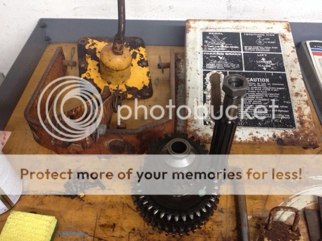

Have a question about these transmissions that maybe someone who's had their share of them apart can tell me. I had a rough growling noise only during travel, any gear forward or reverse. Pretty loud and constant. I disassembled the entire rear end and found a lot of metal shavings as seen in the last pic as well as a part of what looked to be a bearing cage, I lost it unfortunately. Problem is that I was expecting to find a bearing or something that was bad but nothing. Carrier bearings, pinion bearing, input to gear reduction bearing, all fine. Anyone got any ideas? Thanks

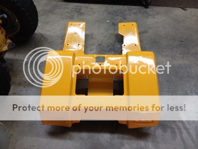

Slowly but surely getting the 800 done. I think I'm finally getting better at body work and paint. Sure trying anyway, it's all about patience and taking the time that's for sure. Got paint laid down and some assembly so far. Rebuilt motor .020" over, replaced broken governor, having fun with this one

Hey, I missed your post a long time ago about the trans. Did you decide what to do, or find what was causing the noise? If not, post some pics of the bearings.

As far as the trans I honestly found nothing other than very small pieces of a bearing cage and a lot of small shavings. Went through every piece, cleaned it all out with diesel, and did a pattern and checked backlash, seals and gaskets, that's it. I actually threw it in before I rebuilt the motor and paint and thought it would be the same, and to my surprise it is now quiet as a mouse. Ive talked with other guys with the same noise but they had never been inside theirs. Stand by for a pic of the dash and thanks for the kind words
