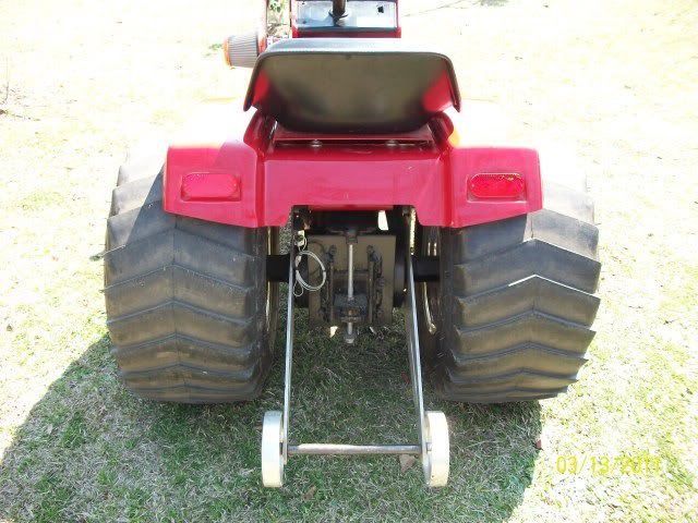

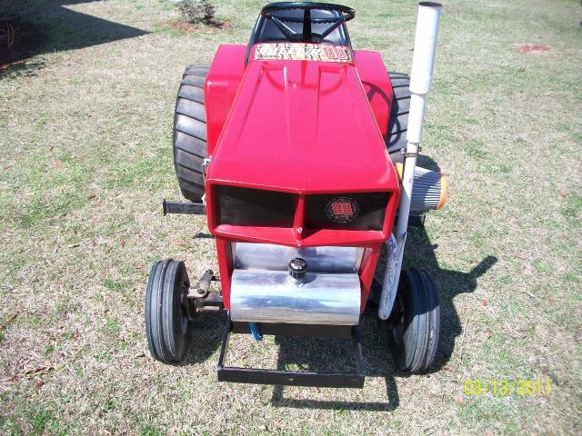

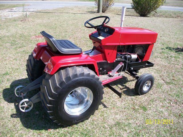

Went to the local track to watch for the first time yesterday. Found one for sale and I bought it. I think I got a decent deal on it.
I was advised to get a 16/18 gear set for the transmission (already ordered)
I also bought some suit case weights,Velocity stack, new header and a few other little items.

Good looking puller hjsmith00843
Old 03-13-2011, 11:47 PM
Your puller is pretty tough looking!

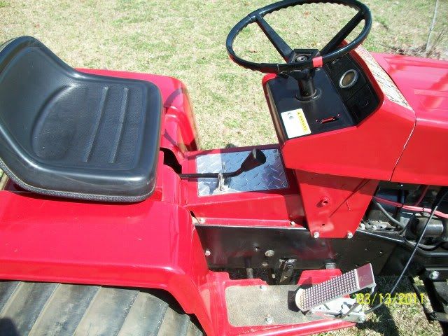

oops double post. Anyway what steering wheel will fit? I would like to change it out to one that suits me a little better.

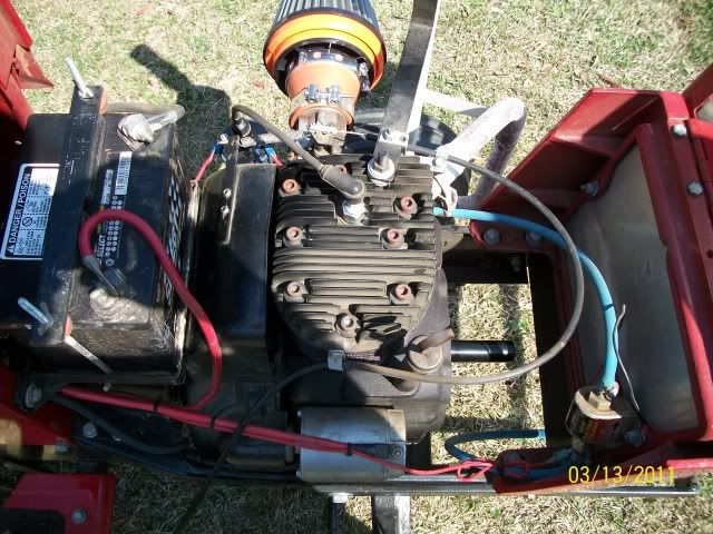

I just ordered me a new carb. I pulled this one off and it was gunked up and full of white deposits. Throttle shaft bushing was also junk. (my guess e85)
So I ordered a new carb

also if I move my battery to a lower location will that help? I was thinking about moving it in front of the motor. This would move it alot lower and closer to the front. I would have to cut off the excess portion of the crankshaft. Can I do that?

That would be a nice paint scheme. I was in during Desert Shield, but didn't make it over there. Some guys move their batteries, some don't. Depending if you pull a stock class, some clubs use a contact less or infrared RPM detector shooting at reflective tape on the crankshaft. If you cut off the excess, they may not be able to get an accurate RPM reading. Do you have a copy of your club's rules? Clubs have different rules for different classes, what works in my club may not work in yours and vice versa.

Installed my new Brian Miller carb
Installed new clutch spring (red)
replace the release bearing lever (old stock one was cracked)
Installed the new header and made a new bracket for it
Changed the oil
Installed some diamond plate foot rest pads
Replaced the breather cover and gasket
