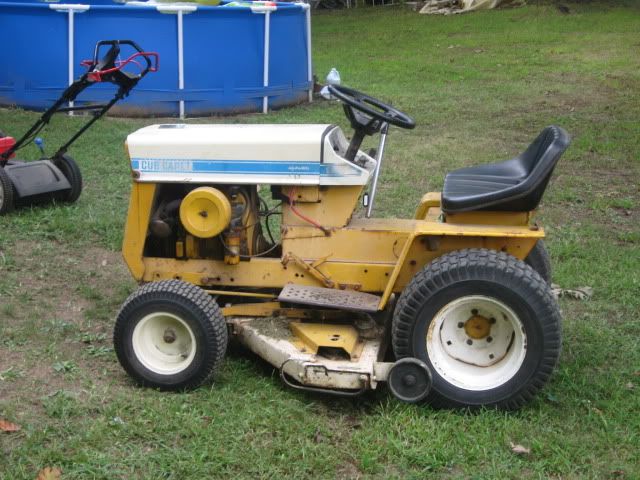

Most of the narrow frames has very little clearance between the steering wheel and hood. So any misalignment, bent frame/grille, steering wheel, etc. will cause the hood to hit. Here's what really cures the problem:
Someone put a different steering wheel and column on this 125. Problem solved.:biggrin2.gif:

That's a good way to fix the problem, Terry. It looks good!

Allen,
That steering wheel also feels comfortable where the location is. The previous owner I believe made that mod.
