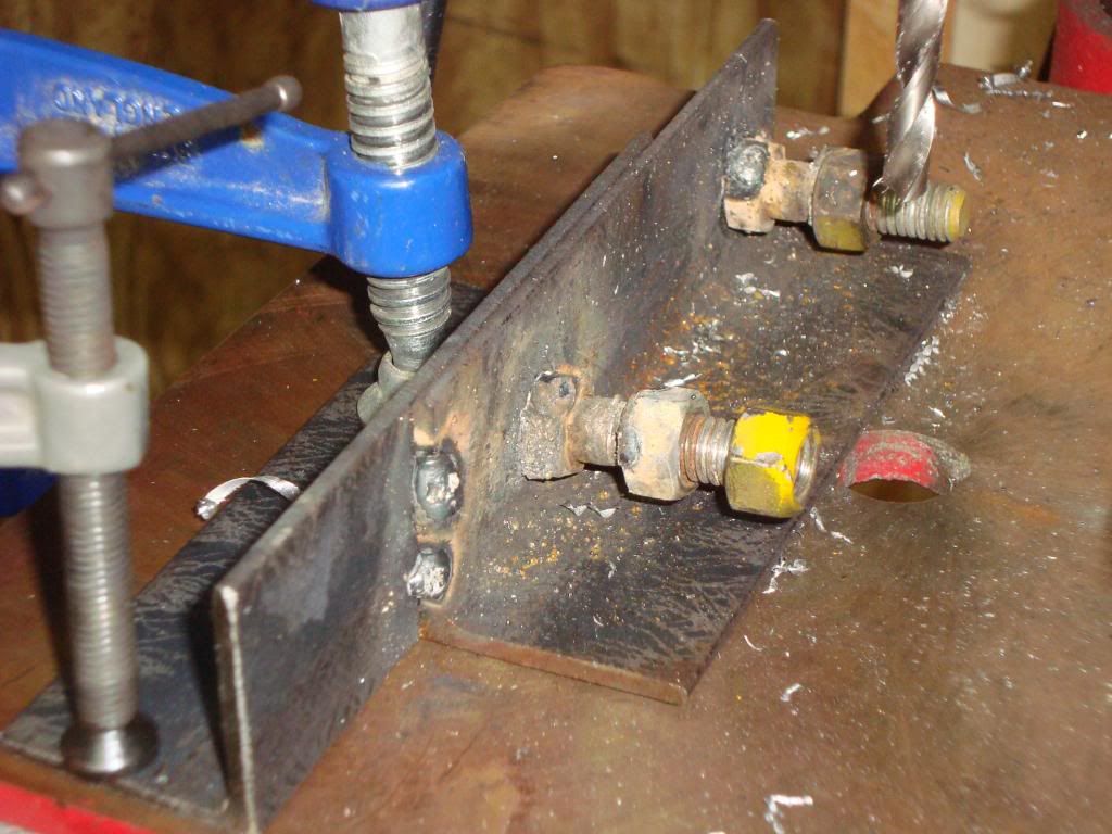

I made a jig to hold the rag mount solid so I could drill the spiral pin hole in the center of the new 5/8 rod I got to replace my old shaft. Just thought it might help or inspire better jigs for the hydro guys.

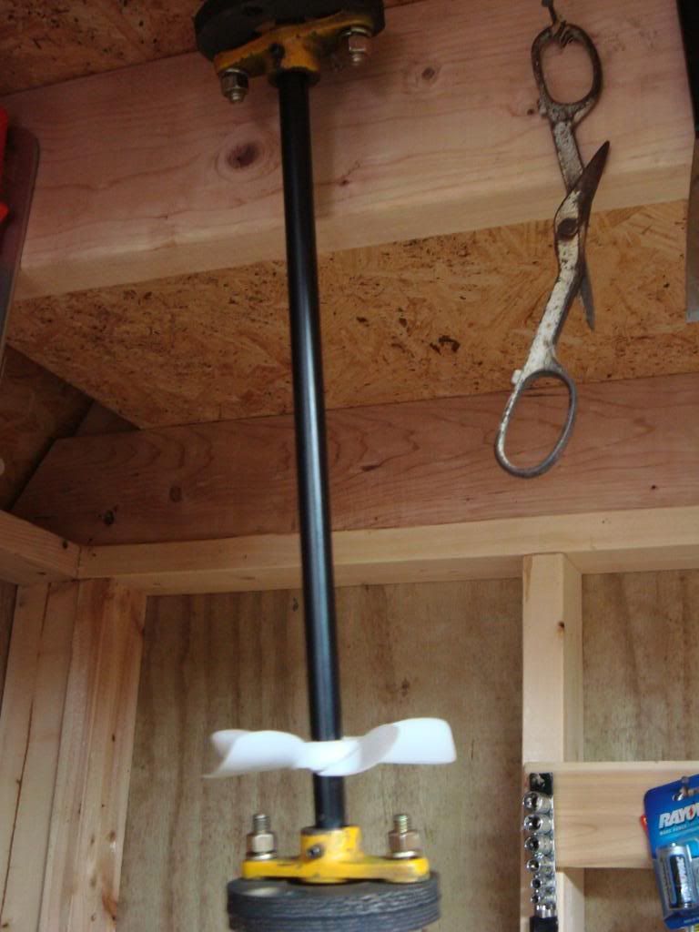

Pic of my fresh drive shaft
