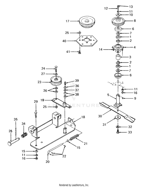

Went to mount my 60" Haban deck and one of the spring-loaded pins, nos. 28, 34 and 35 on the diagram is missing. The previous owner has replaced it with a bolt and two nuts.
Would anyone have these, the pin, the spring, and the roll pin or I would accept the entire plate no. 18 if someone had it available?

Is is possible that the part your looking for is part of a different sub assembly? Even obsolete parts are usually in drawing just NLA. McMaster's has a bunch of pins,springs, etc

Last resort take the good one to a machine shop and have one made.

No, those three parts have their own separate part numbers.
HA-20308 (Pin)
HA-5681 (Spring)
HA-GM9416147 (Roll Pin)

Ok. I misunderstood. I thought you were looking for part numbers

Just a FYI, the early Haban decks just used a 3/4" round bar stock with a hair pin clip on each end. The bar went all the way across the hitch.

Pics of my deck.

Take the existing factory pin and the bolt out, and replace them with a solid rod with a couple holes drilled in it for a couple hair pins.
