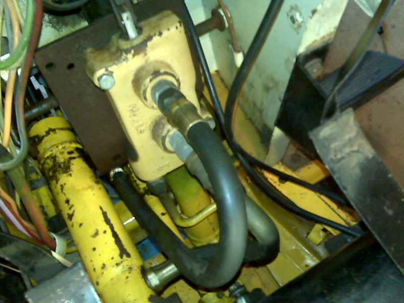

Man when it rains it pours. I got my new lift handle on today, got everything put back together and noticed I was pouring out hydro fluid. It's coming from one of the hoses. But it looks like the hoses are routed wrong, or they are connected to the wrong ports.

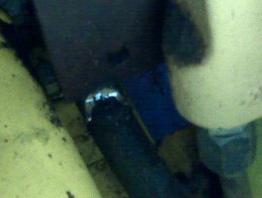

Please take a look at the pics and let me know if you can see what cause the hose to leak. It looks like the hose was getting pushed up against the valve support plate over time. I can't believe that this just happened in the 8 to 10 times that i have moved the lift arm since the engine swap.
From my parts drawing it looks like the the top hose should be attached to the forward part of the cylinder assembly, and the bottom hose should be attached to the rear port on the cylinder assembly. Mine appear to be reversed from a previous owner.
Let me know what you guys think, and how big of a pain can I anticipate this repair being?

Get the hose made at a parts store or equiptment dealer. I would get it slightly longer, and have them slide a piece of heater hose over it before they crimp the ends on to protect it where it rubbed.

It appears as though the upper hose should have been routed below the lower hose where they intersect. Right now being on top it is forcing it to come in contact with the plate that has worn a hole in it.

You could also get some more clearance by sliding the Spool Valve Mounting Plate up the Steering Column a bit.
