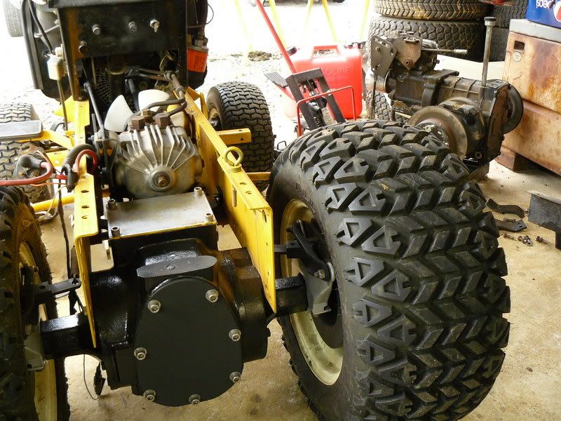

I paint as a whole, then remove rear cover and clean and paint it separate, then use nice fasteners for a quality finish.

And that looks nice. I just cant decide on painting mine black or yellow. For now it will be black as I am going to put a coat of POR-15 on it. Later I will either use some POR chassis black, or use the hardnose yellow.

I would also paint it whole. When I do mine for the 1872, I'll paint it assembled, sans brake parts, and then paint the brake stuff separately and put it on. I'll also remove the top cover and fill with Hytran after the paint has had a chance to dry. I'm not sure what you're using for paint, but another reason to paint after assembly is that any Hytran you get on the fresh paint might bubble it, especially if you either used rattle cans or didn't use hardener.
