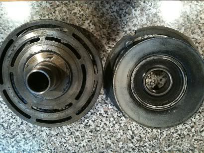

I took a complete electric PTO assembly off the 1250 I'm playing with. It is complete - but since the tractor does not run and most wiring messed up, missing or cut, I don't know how to determine if the PTO is bad, serviceable, or possible even in good shape…. Not pictured is the coil part, but it is in at least as good, if not better condition than the one I just took of a tractor that I know worked.
This PTO, unlike the one that came off the working tractor (working ion the sense that both tractor and PTO work), readily came apart into 2 pieces when I pulled it off. I soaked both of these pieces in evapo-rust (they were fairly heavily rusted) and the rust and most of the paint came off. The evapo-rust is essentially an organic, enzyme based liquid remover. The enzymes "eat" the rust (and organic based paints), but the liquid is harmless to most everything else and for the most part is h2o. The issue I didn't consider was the bearing in the center of the hub. It turned freely before the evapo-rust, but was slightly seized after. I was able to get it turning freely once again, but I realized that it looks like a pressed in bearing and I don't see any way of re-greasing it.
Could someone go over with me what to do to assess and test a PTO for serviceability and what, if anything to do about lubricating the hub bearing? Also, when, is the PTO deemed caput? If it is done, are there any parts worth keeping/reclaiming or should they all just be tossed?

Pry the seal out of the bearing with a very small screwdriver, wash it out with mineral spirits, and pack some grease in it, and replace the seal. Leave some air space in there, or it'll come out the seal. To test the coil, just put your VOM on the ohms setting, and put one lead on the coil wire and the other on the backing plate. The resistance should be 4-8 ohms or so. I'd save the parts even if something is bad. The coil can be rewound if you're ambitious, and the other parts do wear out occasionally. The usual failure mode is the coil developing a short or open circuit, but sometimes the bearings get bad, too. The bearing can be replaced.
