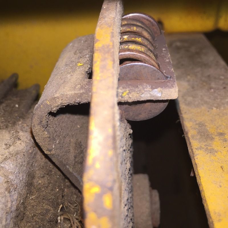

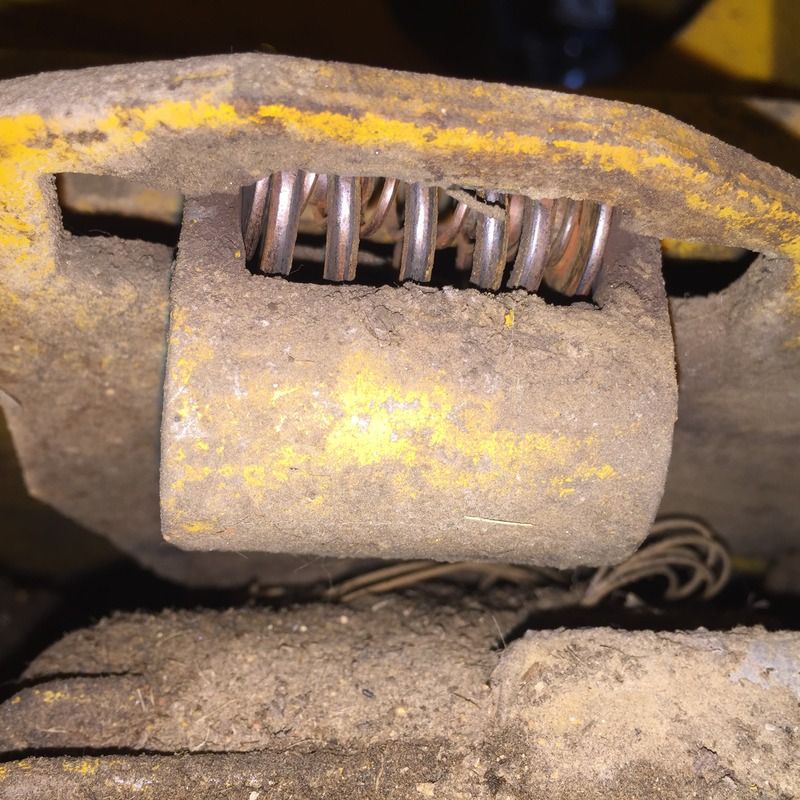

Alright, finally got around to take some pics for you guys. The trunnion looks like it has normal wear like many people have. Tell me what you guys think about it. It doesn't have run away like most people talk about. Also I forgot to mention that the adjustment knob fell off while I was tilling.. I wouldn't think this is related. I just adjusted the hydro to neutral and checked the hydro fluid, all is well. Drive lever is not stiff anymore but doesn't seem to have much reverse still.. I'll know more when I sink the tiller in some dirt today. Thanks.

The springs are working their way out the bottom of the trunion, and the cam plate is leaning and barely contacting the springs. You need to repair the notches in the trunion and shim the cam plate so it contacts the springs in the center. There isn't a lot of lever movement for reverse, any trunion/cam plate slop will affect speed.
