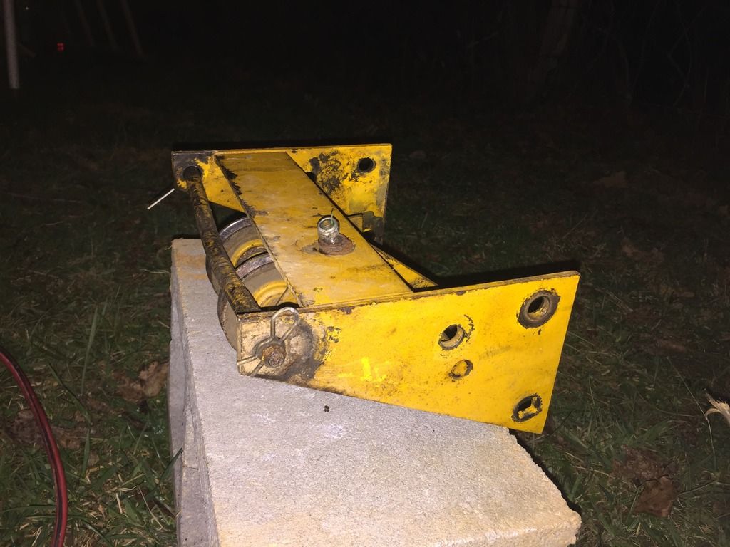

Hi guys, I tried (but failed) to mount my snow blade to my 122 last night. I was unable to get it to to go on--the brackets seemed too narrow for the frame. I snapped photos of the situation and will post them below. After a little google-fu, I think I have to leave my mule drive (?) on the tractor?
Can you guys confirm with me?
Do I use the (bent) rod with the cotter pins from my mule drive (?) unit?
Thanks

The problem is.....the 122 requires a sub frame that "bolts on". Your sub frame was designed for the later NF tractors that have the QA (Quick Attach) feature.

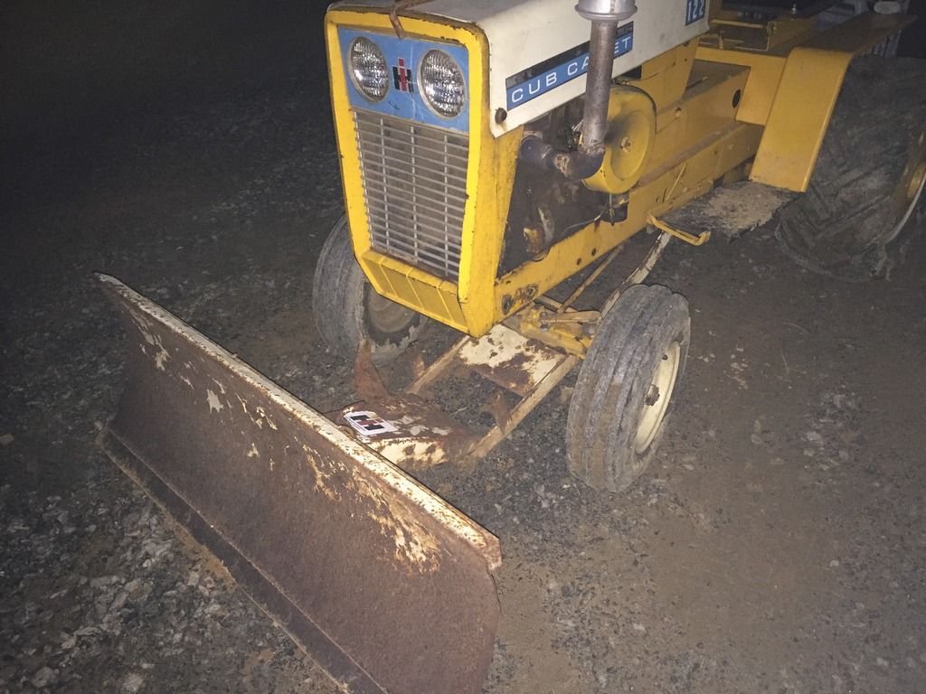

j4c11 emailed me the manuals and it appears the below image is the setup for my particular application. As soon as I repair or find another lift rod I'll confirm this. Thanks again guys! You all are a great resource.

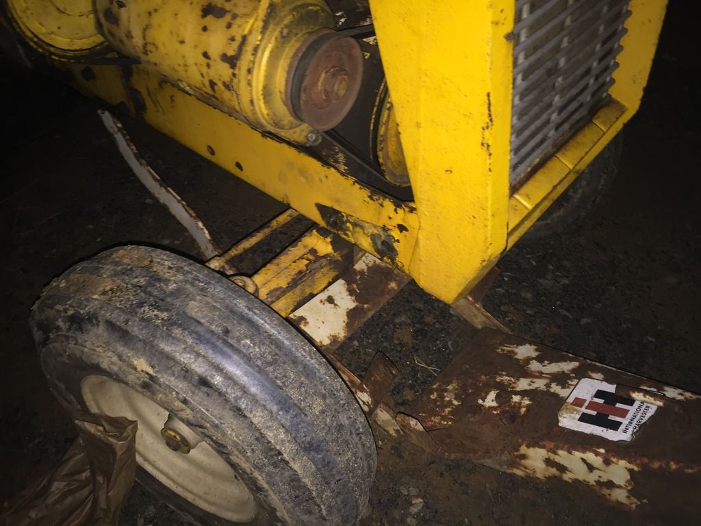

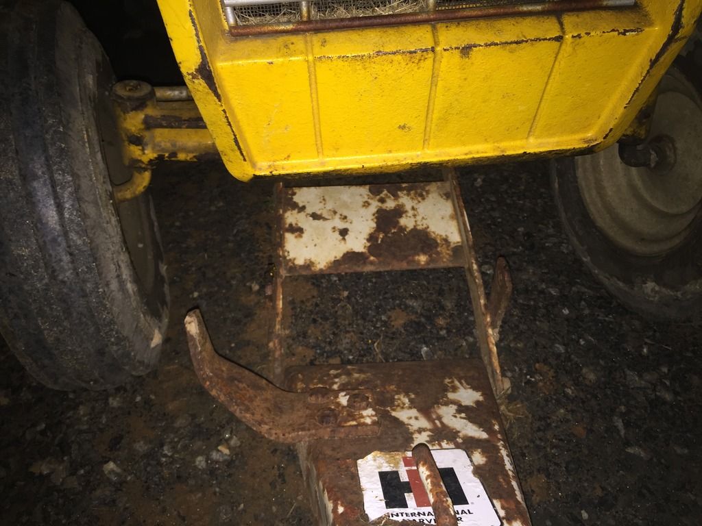

Hi guys, just following up as I said I would. The image from my last post is how I mounted my snow blade. The long rod with cotter pins did not clear the deck pulleys to mount the blade, so I put two 2" bolts/nuts in there and it works great to hold the blade. Used it the other day to scrape the driveway gravel and anticipate I'll be moving snow tomorrow with it.
