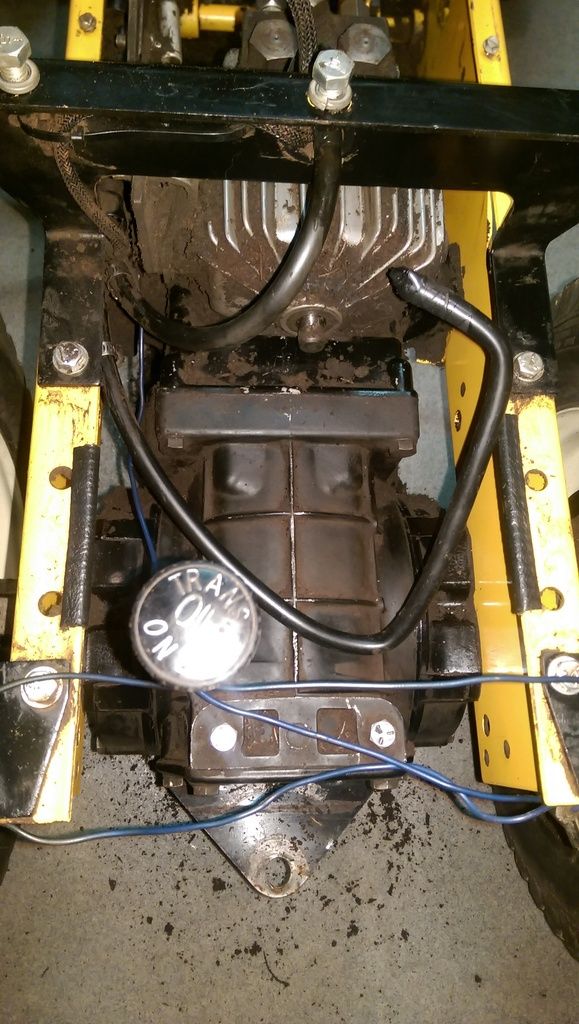

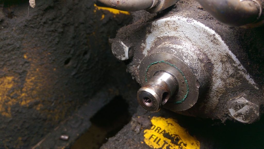

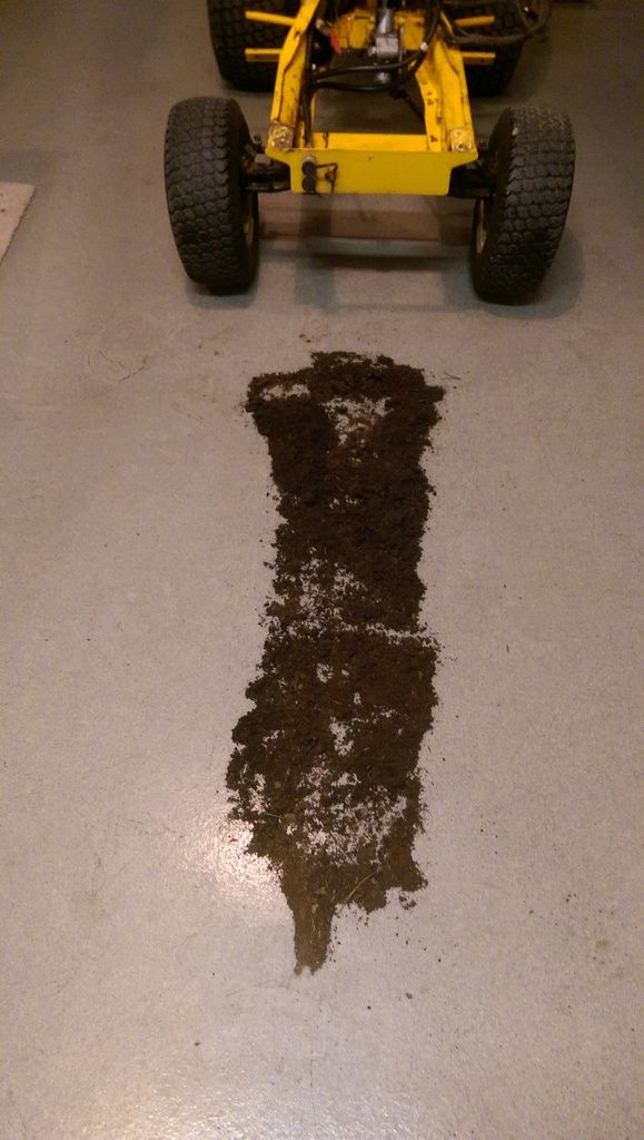

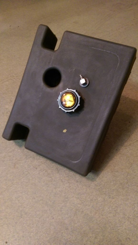

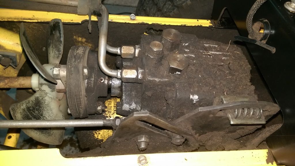

I stared on the teardown of the 1512 I snagged back in the fall. I got the motor out the other day without issue; today it was time to remove the fenders and driveshaft and wipe off some of the crud prior to power washing the frame and transmission. So far, I'm contemplating replacing the fuel lines and doing a rear-end service. I already have the input shaft seal to install, and a gear-reduction starter to replace the factory lunker. I figure I should also do the belts and fluids while the motor is out. There is also some wear on the driveshaft coupling bolts and the swivel coupling at the motor end. I'll get a pic of that up later on so you guys can advise as to the urgency of any repairs that are needed. The trunnion shows very little wear, so at least that's one less thing to deal with.
This diesel has more foam stuffing than any tractor I've worked on!
Yuck!
Much better!
More Yuck!
Niceee...Think someone's been in here already?
I'm also considering adding the block heater since the engine is out and I'm planning to drain the coolant. Has anyone had a noticeable difference with cold starts after adding it?

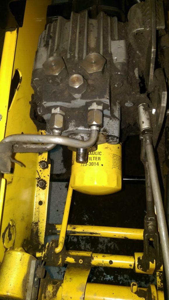

my 782D looked exactly the same when i tore it down... im pretty sure caused by small amounts of diesel fuel that has been spilled over the years dripping on trans

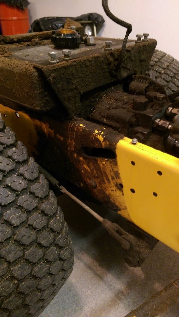

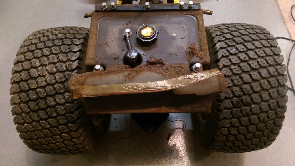

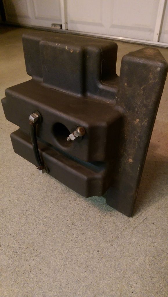

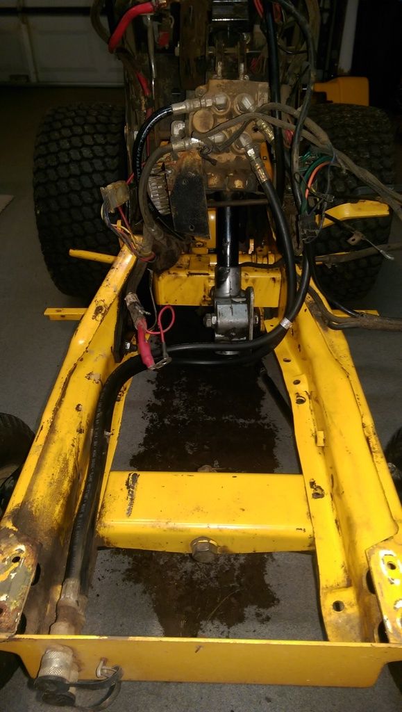

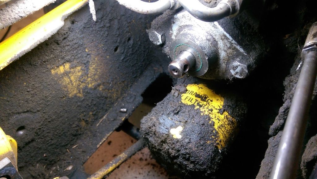

More pics post-crud. She'll look proper after the power washer is finished.
Crumbs!

I would replace all the fuel lines while you have it apart too!
Is that the color of the tank,or is it dirty inside too?

Yep, that's how mine looked too. Change the lines and the tank bungs too. My auto parts store has the bungs for about $2.00 each. I also would probably change the shut off too since you will have it out. I drain the tank of any fuel and use dish soap and a bunch of water to flush the tank good. Both ends of the driveline use the standard ball bushing as used in the other machines and if the adapters aren't too worn you can just do the bushings. Watch the bolts on the front rag joint because the motor and the pump shaft are not at the same angle and the bolts will hit at the 6:00 position. Looking good.

The 1512 I had ALWAYS leaked out the bleeders and the hydro unit was always oily. Too bad yours was allowed to get so dirty. I think there's something about the Kubota that causes the hydro bleeders to leak.

I think the foam is to protect the fuel tank from contact with the frame and mounting hardware and causing friction/leak problems
Replace the bushings in the tank also while you are at it as well as the lines.
