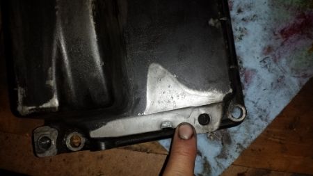

I do have an extra oil pan because I had a small crack in an aluminum one. A cast iron pan should be here in a few days. But I can use the bad pan for a jig as I do these cradles.
cracked pan:
- Tim
