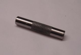

Old 05-29-2015, 11:57 AM
Hey guys.
Here's where my question lies. To keep it from working its way out again, what should I do? Loc tite it in? I've seen the hose clamp repair, but I'm looking for something a little less ghetto.
Thanks!
I can made a knurled pin to replace the smooth pin. I can make it up to .003 to .004 oversize
Old 05-29-2015, 12:28 PM
Terry C's Avatar
Terry C Terry C is offline
Join Date: Nov 2014
Posts: 3,488
You should be able to sell a bunch of those. Way easier than what I did
