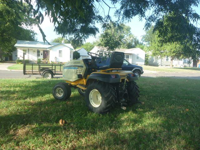

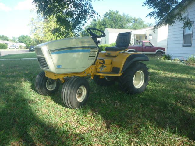

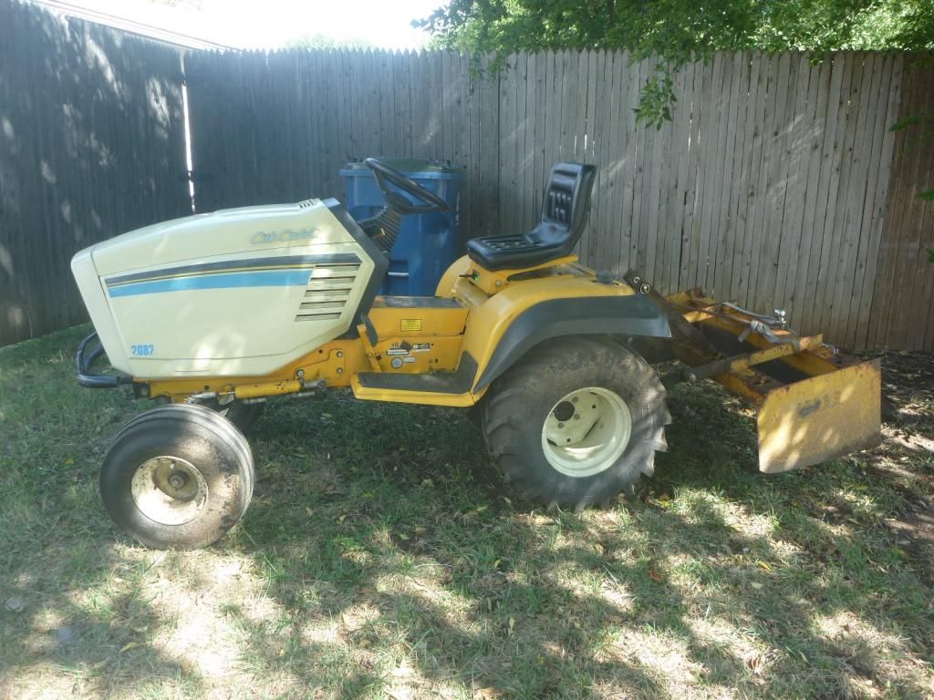

So about a month ago I ordered some fender flares for my 2082 only to find out that the cyclops tractors had 2 different fender pans. Well I obviously didn't know this. So after holding on to the flares for a while I decided to get the right fender pan and switch everything out. I hopped on ebay and found a decent looking fender pan off an 1863 from Joes Outdoor Power, and the rest is history. Here are a few pictures of how it turned out.

Fender flares really do set them off, don't they
Good looking machine, btw!!!

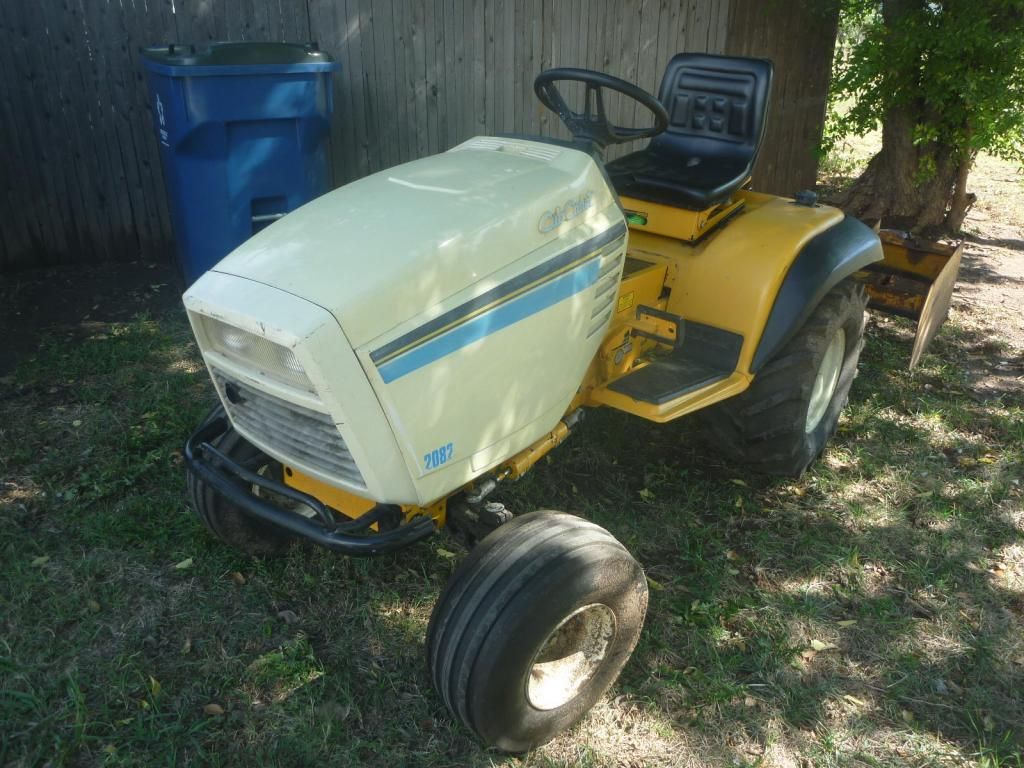

I found the elusive front bumper. Finally!! Thanks to a forum member!!

Quick question, you said you used a fender pan from an 1863, the Supers are a little longer to reach the floor boards. What did you do to get that fender pan to work?
Old 10-12-2014, 05:09 PM
bolivier's Avatar
bolivier bolivier is offline
Location: Oklahoma
Posts: 665
It was a direct bolt on. I put both fender pans next to each other and all the mounting holes were identical. As well as the holes for wires under the seat. I didn't have to add washers, or space anything to fit correctly. Everything lined up just right.
I thought pans were the same, but the brackets on the side of the frame where the pan bolts to, are higher on the frame on supers. Making it possible to use the same pans on all the tractors. I know if you look at a pic of a 2082, and an 1863, the bottom of the foot rests are flush with the bottom of the frame on the 1863. Where as my 2082 the bottom of the footrests is an 1 1/4" above the bottom of the frame. I just measured it.
