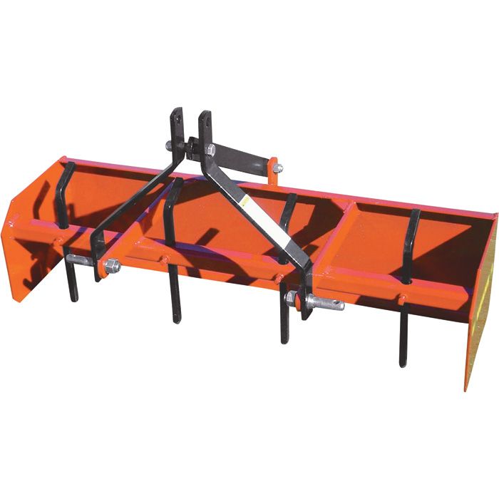

First up is a howse. It is $299 and weighs 119 lbs.

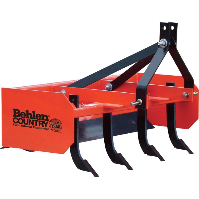

2nd is a hawkline by behlen. It is $599 and weighs 290 lbs.

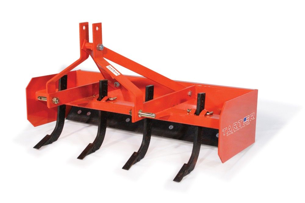

3rd is a tarter. It is $499 and weighs 284 lbs.

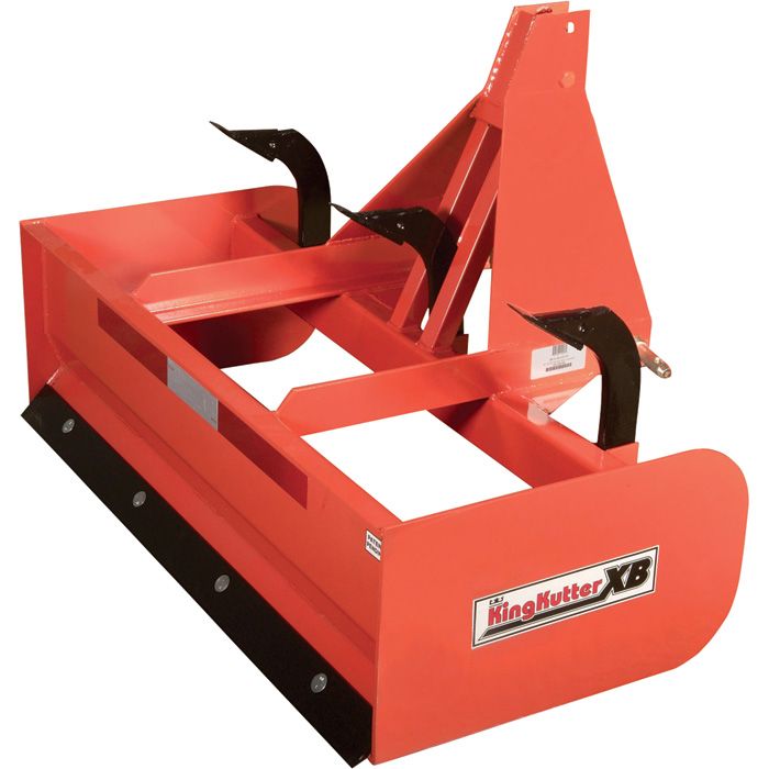

4th is a king kutter. It is $539 and weighs 295 lbs.
I'm leaning torwards the tarter, but if I can't get it locally and have to pay shipping, the hawkline will be the better choice. As I think I can get it locally.

First one doesn't look like it's built very well.
The other 3 look ok.
When using a box blade, you want one with a backfill blade (#2 and #4 have that for sure). You also want good scarifier shanks. 2,3,4 have good looking shanks. Your choice. FWIW, the tractor will limit you more than the blade will. But the first one is a definite no for me.

I vote #3. Looks well built. Has 4 rippers. more expensive, but it looks like it would last a long time. my

"Double-sided blade allows for grading in both directions." From the ruralking website about the tarter box blade. The tarter and the hawkline almost look identical.
