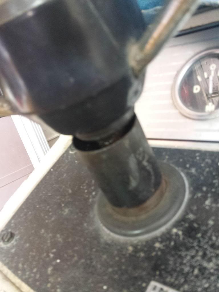

Well i was getting the cub out today doing the maint on her (grease the fittings, change the oil, take the blower off and put the deck on) and I noticed the steering wheel is very wobbly and seems that it's come apart? Is there any members that sell rebuilt ones? Please see pic. Any ideas?

Mine did that (1450), bushing was just about gone. I pulled the wheel and put a wheel bearing for a 3/4" spindle in it.
Agreed. Upgrade to the wheel bearing. It's the same one that's used on the steer wheels.
I did the same thing.

Check to see if the shaft seems to screw up and down as you turn the wheel.
It kinda looks like the "tube" has moved up in the bushing recently.

I did the same on my CC149, wheel bearing in the column. Made a world of difference.

I did this as well on my 104, but it was a very sloppy fit. I put a few wraps of aluminum duct tape around the shoulder , it worked perfect.
I agree with Yosemite Sam, it looks like the tube has moved. Let us know what you find.

Tube does look like it moved but spacer bushing definitely looks like it's gone

I used a hose clamp on mine since it also fit loose.
