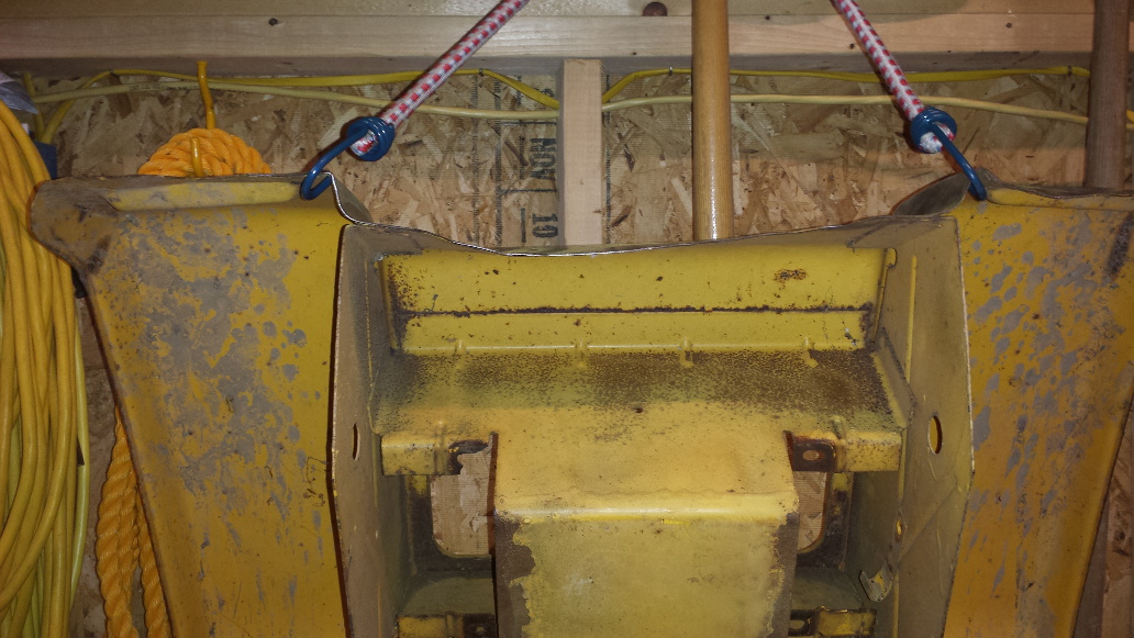

Is there a quick and dirty way to smooth this out a bit? (clickable image)

That should be easy, with a dolly and body hammer.

I've used an adjustable wrench to straighten them. They won't be perfect but pretty close.

You need two hammers, one for bottom one for top...the bottom one you hold against the top one you swing lightly and methodically...its all about how you place the bottom hammer during the swings...try it, off to one side or the other, youll get a feel for it...a dolly makes up for the bottom hammer, but for a spot you can get to so easy two hammers works better....little 2k primer, little fine filler, and youll have her straight as an arrow.....

That metal looks like it is stretched. If it is, you'll have to shrink it back with a shrinking hammer and body dolly the file it smooth. You can use heat too but I don't want to have to describe that process in writing.

The trailing edge of my 147 fenders looked about like that. Stand them up on a 2x4 and prop the tops against a wall or something. Adjust the angle until the back slope of the fender edges lays flat on the 2x4. Get a ball peen or smooth head hammer and pound the waves out. The ground and 2x4 gives a great surface to work against. Light taps, work up and down the trailing edge. Mine came out very straight.
