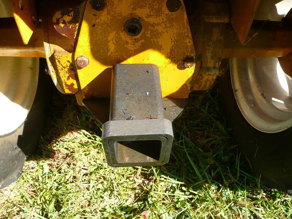

Old 01-26-2014, 08:32 PM
Go to http://www.xtrememotorworks.com/Part...rts%20List.htm
To get this:

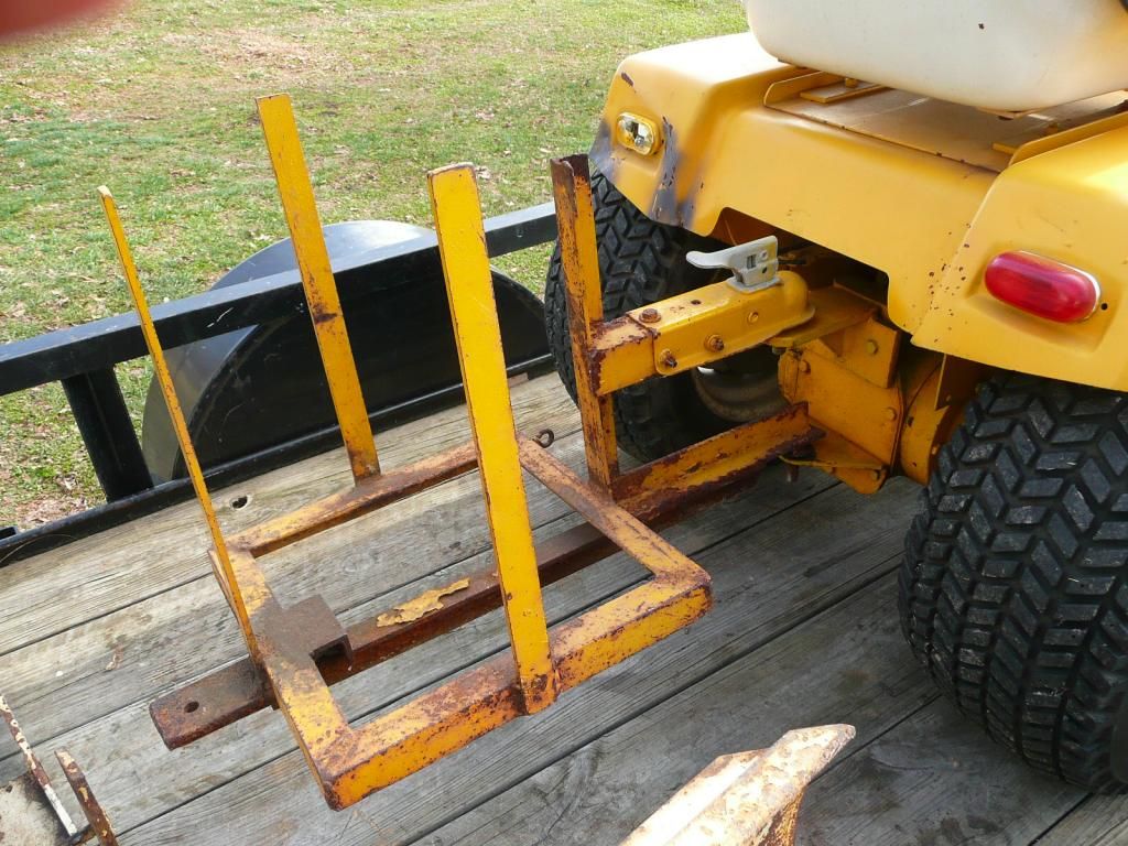

Old 01-28-2014, 02:14 PM
OldAndInTheWay's Avatar
Join Date: Jul 2013
Posts: 624
This ball hitch came with one of my Cubs.
And another:
