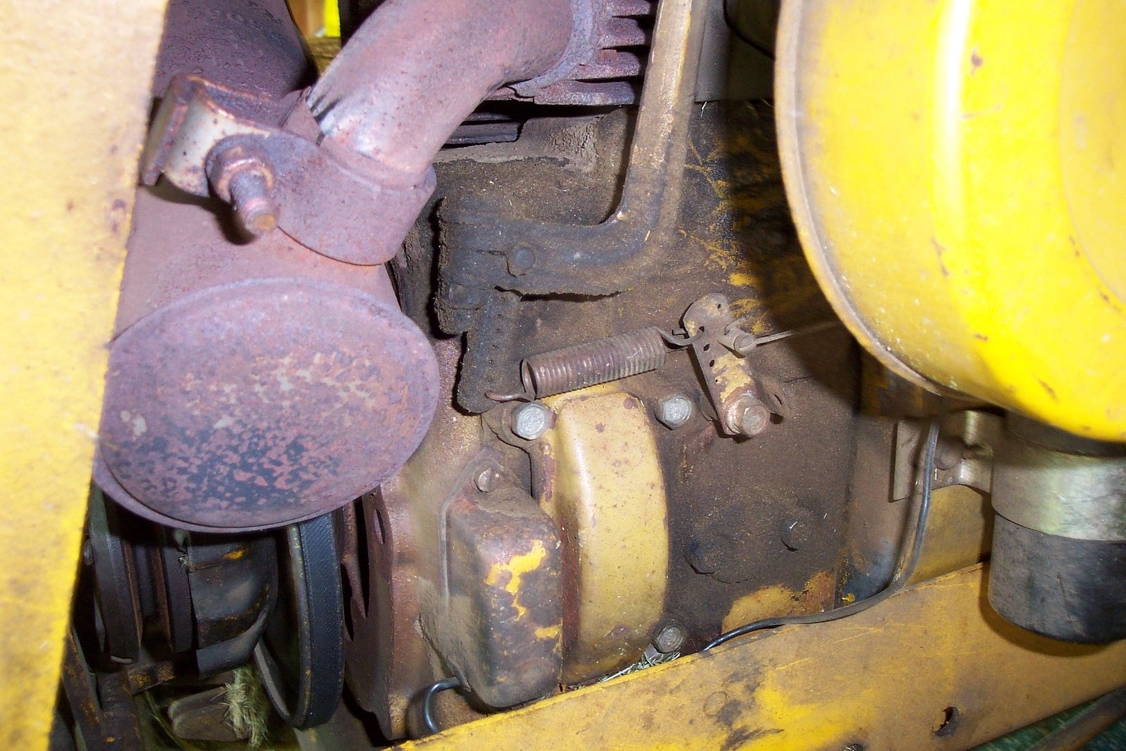

As far as the points go, when I tried starting the new motor, it didn't have any spark at all. Checked and found the points a little corroded. Cleaned um up and now has good spark. How do you adjust the points and what is the setting.
Just wanna make sure the points we are talking about are the contacts on the lower left side of the engine behind a small cover right?
Old 01-19-2014, 07:40 PM
click for bigger pic
The smaller cover on the left with the wire going to it
