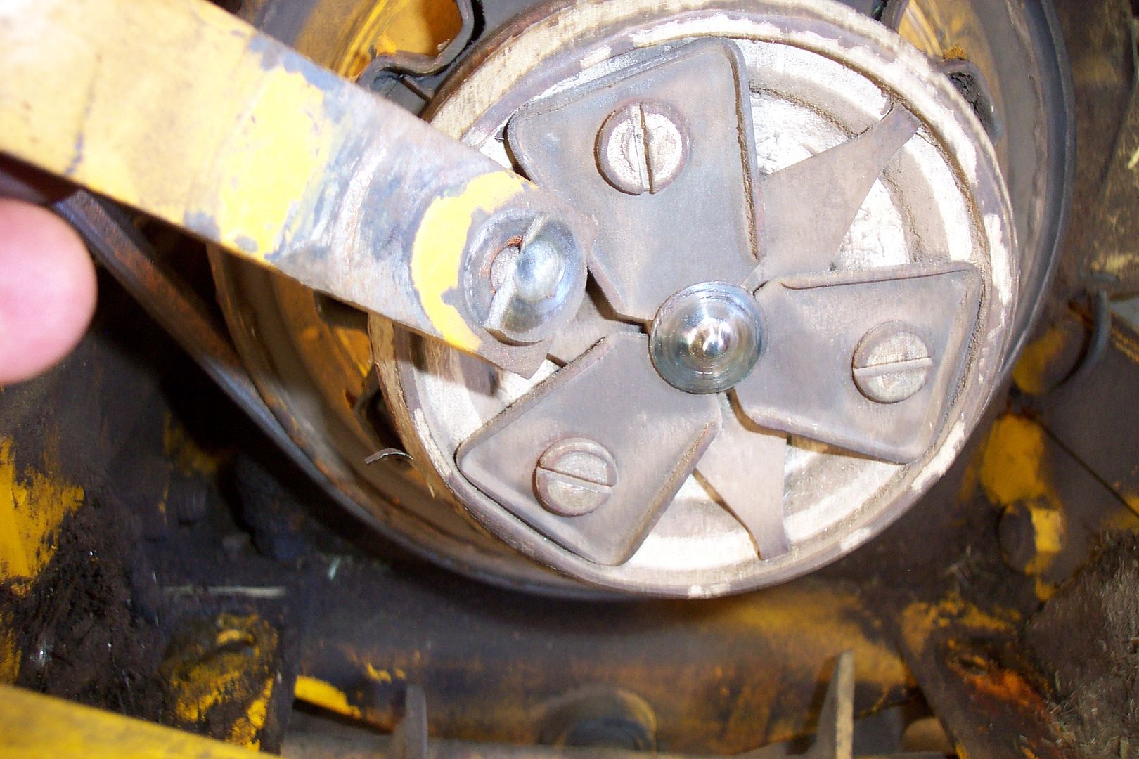

i was referring to the one on the pto pulley its self i know how to replace the one on the lever

I believe You will have to remove the PTO and dis assemble it to replace that part. The flat springs are held in place by special bolts w/nuts and jam nuts on the inside and will require proper adjustment when reassembling.
Would probably be best to recondition the entire clutch at this time for best operation.
Here's a link to the process
http://www.cubcadetman.com/content/i...lley&Itemid=53

And by the looks of it your actuator lever where the button presses in may be roached as well. That's quite a point you got there, good luck and pb blaster is your friend.

Yup you need a new fiber button (that's probably why the other one is pointed.) Looks like a PTO rebuild is in order.

That looks just like the ones on my 122 when I got it.
I rebuilt the PTO and installed a brass button.
