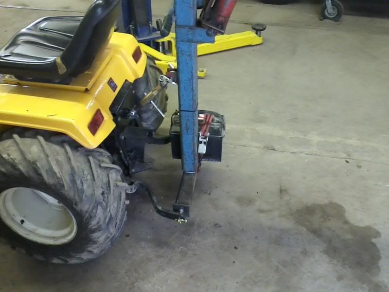

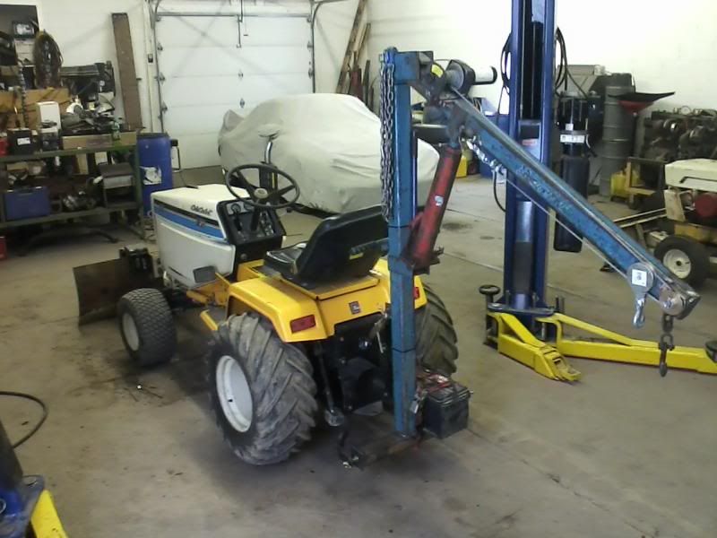

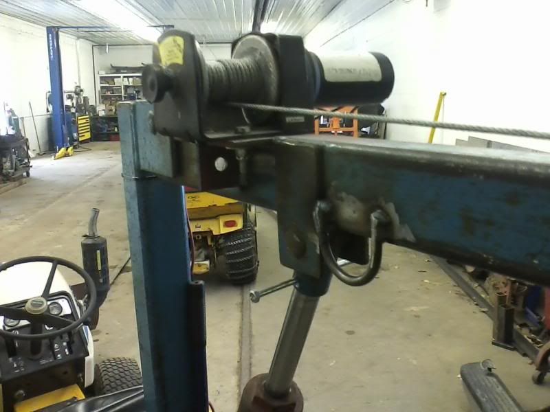

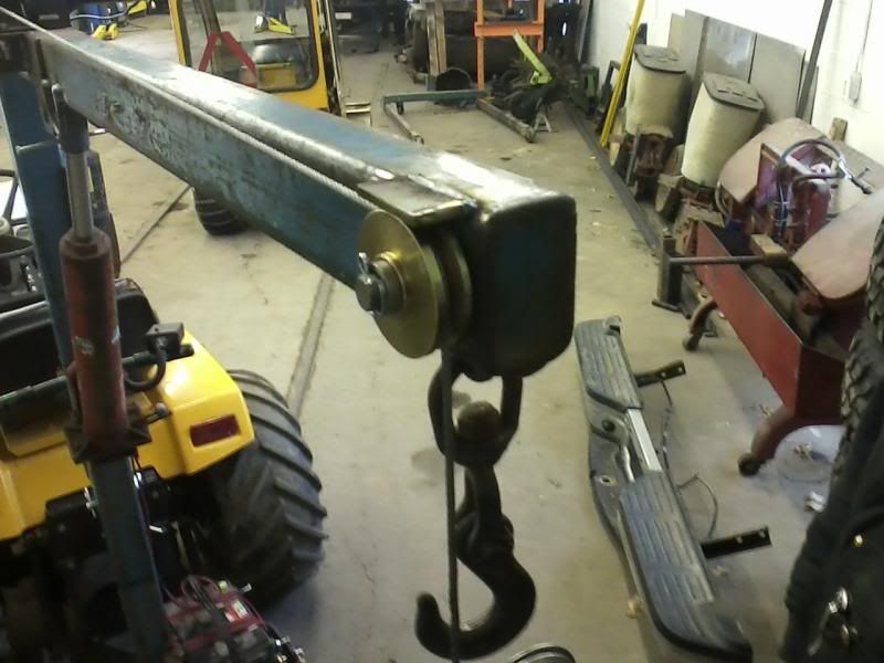

I decided to put together a crane for the back of my 1572 this weekend. I have been wanting to build this for a while, and I think it will prove itself to be very useful. I will probably pull it apart some time and paint it. The best part is I can still pull the upright and boom off and use it with the original legs and a roll around engine crane. The winch is a 2000 lb. ATV winch and it can be run with the snatch block to bring the weight close to the tractor.
The transfer case in a few of the pics is a cast iron np205 with cross member (so it is pretty heavy) and it picked it up no problem and was very stable. I am looking forward to see what it can do.
