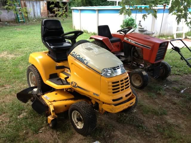

Hi yall,
My brother called me last week and said he bought a cub cadet. It had quit on the owner while mowing so he went and bought a zero turn.... cub cadet of course... Since my brother doesnt have a place to keep it, he asked me if I would. So yesterday in the rain, we went to get it. Its a 3240. Its not in bad shape.. I got it to run, but it didnt run well... I backed it off the trailer and figured out which cylinder was down and pulled the valve cover. I found a bent pushrod... hopefully thats all thats wrong with it.. parts are ordered, so we'll see.

I have a 3235 with the 23hp kohler and had also had a bent pushrod. Mine had sat outside and filled one cylinder with water.
Hi,
How hard was it to fix? I hope this one didn't drop a valve seat...
Thanks,
Stuart
Stuart in Hopkinsville, Proud owner of an Original, 100, 73, all of which belonged to my dad, 125 with lift, hitch and 1a tiller, 126, 147 also have a 1961 Bolens ride-a-matic, a case 222 and a case 446.
Old 08-02-2013, 06:37 PM
Pa Cooner's Avatar
Pa Cooner Pa Cooner is offline
Posts: 86
Initially I just pulled the valve cover off of the affected side and removed the rocker arm then replaced the pushrod. Once I had it back together, I ran great but smoked like crazy! Ended up pulling the engine out and tearing it down to hone the cylinders out. Honestly, just replacing the pushrod, about 20mins if you take your time and drink a can of pop along the way.
