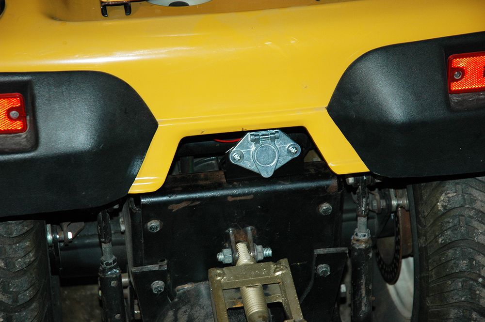

I use a plug in arrangement to power my 16 gallon sprayer. The 1872 had a plug, but, it is gone now.
So I added one to the 2284. Boy I got lucky, there was an extra white wire hanging back there!! WOOT!
I connected this trailer plug to it.
The other end of that white wire was under the dash with another nice connector on it.

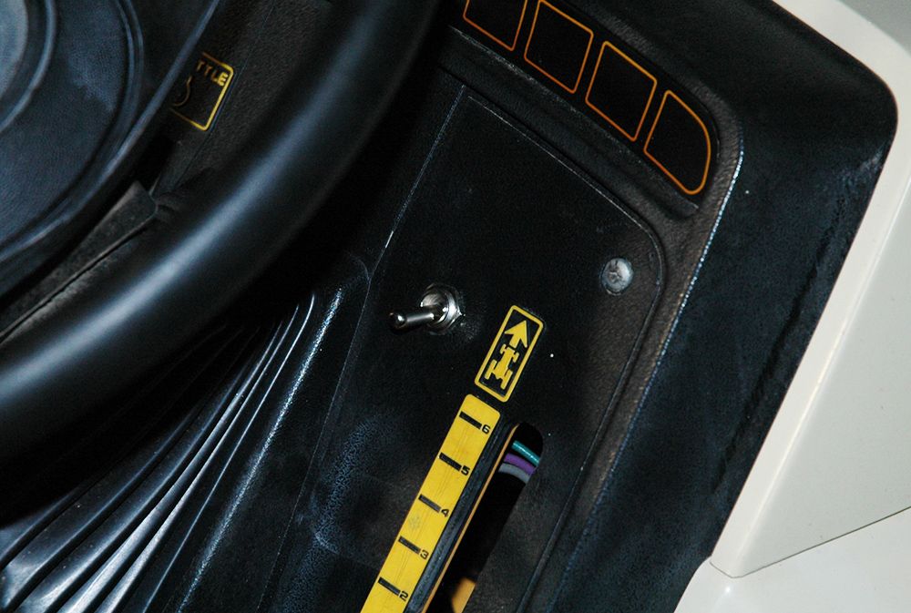

I added a switch, and a fuse.

That would have been for the rear PTO if it had one. Looks good.

I kinda thought it was the PTO wire, or else the PO had removed the backup lights!!
Having that wire in the harness allowed me to make the under dash wiring look factory.
Everything is soldered and shrink tubed.
It took some digging to find just the right terminals that would plug into the harness, I never sorted the 5,000 mixed terminals that were given to me!!
