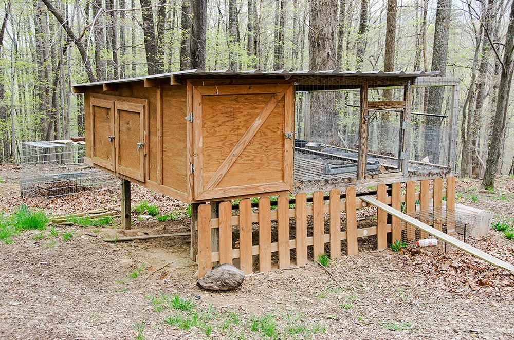

And, remember, there are alternatives!!
The wife wanted a chicken coop, and I ain't no carpenter!!
I just put it together with outside use screws!!
AND, lots of "liquid nails", the stuff in the tube, like glue.
The coop is "bulletproof"!!
A few screw bits is way cheaper than a gun, and no compressor is needed.
But, then, I ain't buildin' a house anytime soon!!

Cad , You are right , screws/glue are hard to beat !!! I use them all the time , especially since i got a battery powered impact.
Every once in awhile though i need to drive some nails , occasionally framing and i will end up using the finish nailer alot.
Nice lookin' chicken coop !!!

PS CAD your coop looks pretty good for no experience.
