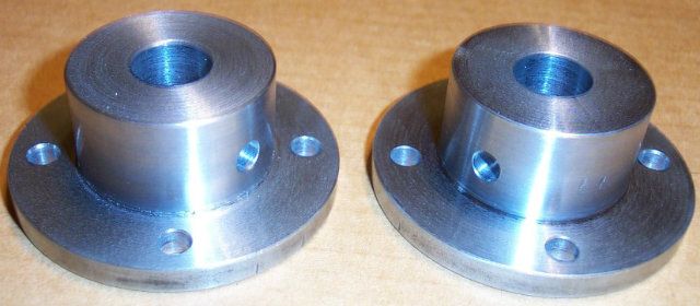

Default (Sam Mac) your engine adapters
How do these look
( yes, they're both the same diameter)
Now that I made them to your drawing, what do they fit ?

Jeff
You did a killer job on the adapters. They will fit the hydro input shaft for the older style pumps that use the spirol pins and will bolt to the Cyclops style CV joints or the 2000 series type that use the plastic barrels in the coupler. One of those will be going in my Deere Cadet dump. That was a JD 317 that I stretched and put a Cub CH22 in for power. I had an M12 in it but it needed more power so being out of my mind and having a new CH sitting on the bench, well you know how it goes. Anyway if these work the way I expect it will simplify those re-power projects as far as the drive shaft is concerned. I’ll post some pics of the project but cut me some slack over the Deere thing.
The pic of the shaft has a 2000 series pump adapter on it but the one that Jeff made for me will replace it so I can pin it to the pump. JD 317's just happen to have the same input as older Cub hydros.

Thanks for the compliment on my work. I don't make anything I wouldn't use myself.
The last attachment made it perfectly clear on placement of the adapter.
I have material for four more here at home.
Jeff

Jeff
Got the adapters today. YOU ROCK! They fit perfect.
OK you guys with older hydros if you have had all the fun you can stand with the rag joint rock and roll give Jeff a shout he can hook you up with an adapter that will allow you to convert to the Cyclops CV joint or the 2000 series shaft. The 2000 stuff has a 5/8" ID tube so all you need to do is cut it the tube and insert some 5/8" cold rolled and make what ever lenghth shaft you want. This is on a JD 317 pump but the input is 5/8" OD with the spirol pin like most of the older Cubs.

I had a good drawing plus he sent a part with the correct bolt pattern so I could verify the measurements. Since I have the correct tools and the skills, it was easy to manufacture.
Jeff
