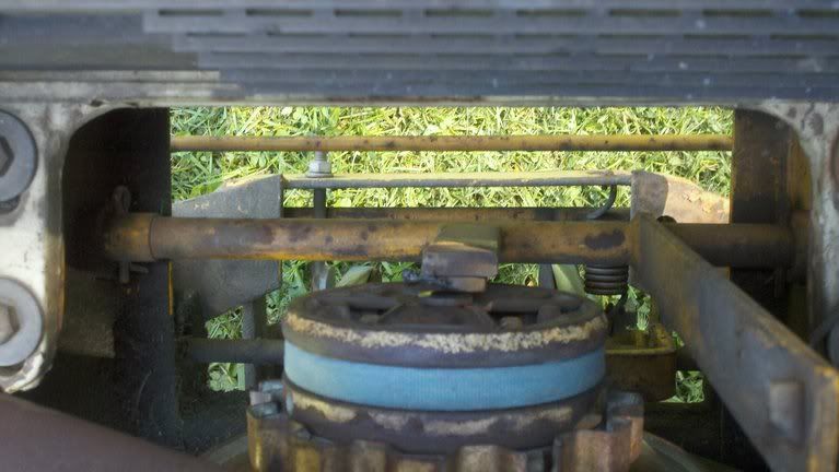

Hey guys I am new to the forum. And a new cub cadet owner. I bought my first cub a 149 after my piece of junk craftsman broke down again. I love my new to me 149 but she needs some work.. I guess my first question would be that my pto will not disengage. The lever and linkage move just fine but the blades just keep turning that little button that sits on the front of the pto was fine but is messed up now because the pto wont disengage, I did replace the belt. The new one is pretty tight I put a 79" belt on that was way too loose so I put a 77" belt on and it is pretty tight. Also I have a 50" deck. Any ideas guys? Thanks in advance for any advice

You have a mechanical clutch as opposed to an electric one. I looked at the pic of your clutch and it looks like the lever with the button is off center and not lined up with the center of the clutch. I also could not see a button on the pto and it should have one. Looking at the rock shaft that holds the lever the one side looks like it has moved to the right. That could be the reason for the pto not shutting off. If this is just an optical illusion then I would guess that the bearing which is attached to the pto shaft may have siezed.

Depending upon the condition of the fiber button on the end of the pto rockshaft, that may just require a simple adjustment of the turnbuckle that links the pto lever to the pto rockshaft. When the pto lever is forward, the clearance between the fiber button on the rockshaft and the thrust button on the pto should be .030inch. About the thickness of a matchbook. You'll find the the service manual for the 1X8/9 tractors in the technical section of this website, page 2. There's a great diagram of the mechanical pto's in there. And all the info you need to service and adjust yours. And, Welcome to OCC!

I think that the fiber button is pretty much shot and the turnbuckle is kinda stripped. I say kinda stripped because I can adjust it some but once I go so far the threads just let go. Any suggestions on where to get this stuff? Thanks for all the help guys

Chris at Cub Classics, one of the sponsors at the top of the page, can help you out. He's got new fiber buttons, new turnbuckles, and he's got used pto rods if you're rods are shot.

Just ordered The parts from chris. Along with a few others.....thanks again for all the help. I will keep you guys posted as to how it works out.
