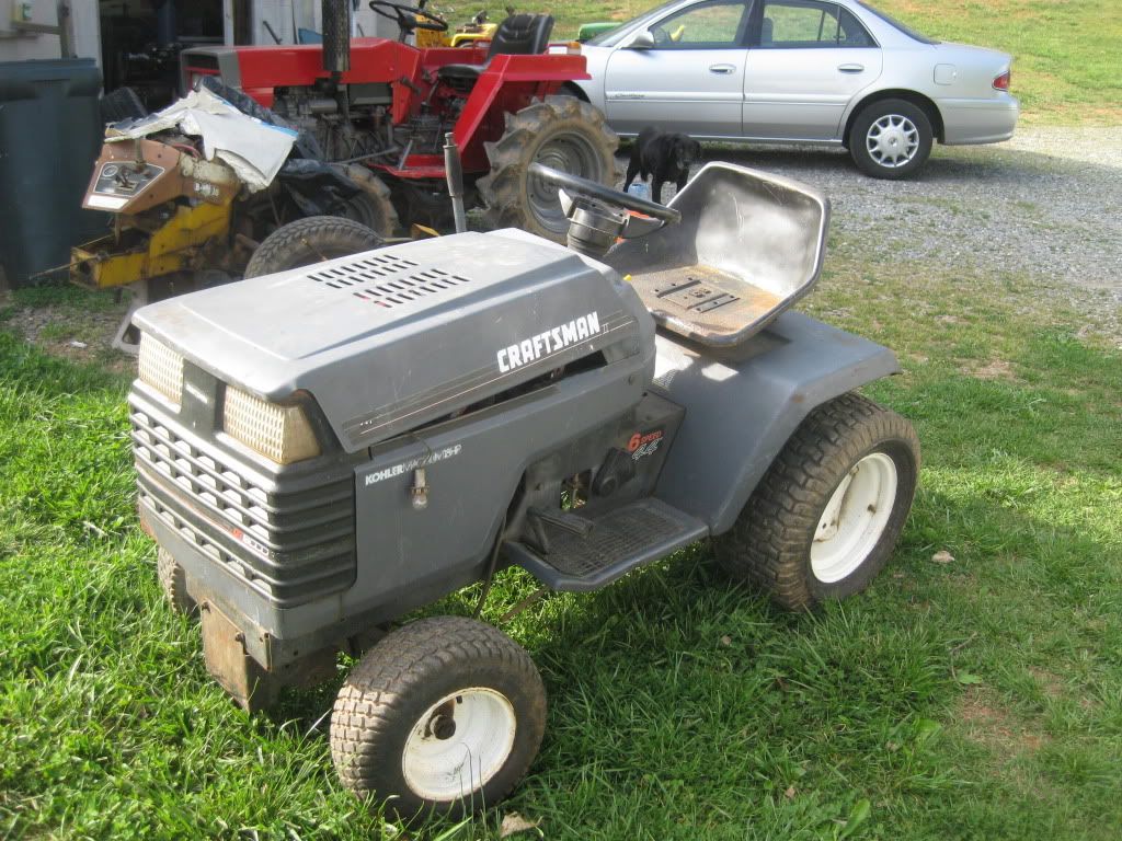

I saved this crapsman mower from the scrapper the other day, I only wanted the motor. At first sight, I thought it was a series 2 but after some reading I think it might be a series 1 or is there something completely different for craftsman? Could you guys help me Id the engine? What is the difference between a 1 and a 2? Thanks guys!

I can see the tag in the photo. If you could post the serial number and model number it would help. I believe if it has points it is a series ! most likely, If it has an oil filter on the right side it is definitely a series 2. No filter doesn't mean it isn't.
If it runs, ok, doesn't make a lot of difference. I have read there are several more differences. Seems like they had different sized head bolts. I believe someone else might be able to steer you better.
Old 05-17-2012, 09:07 PM
That is a Magnum, which I believe is neither I or II.
That is the same engine I have in a 1872

Ok, spec number is 24665, serial number is 211242386 and the model number was long gone. the engine does have an oil filter.
CAD, that is what I am starting to think, Thanks.

Sticker on the side panel says Kohler Magnum 18? It looks to me like it says 18. Also, a KT-17 would have points and a coil where a Magnum does not. If it's a 20, that's a sweet score. Either way, I guess, it's a sweet score.

wow, Man my brain isnt working tonight. Im speechless, How could I forget that. Its a 18 hp magnum, I picket it up for $100. when I got it at the scrap yard I paid $16 dollars a hundred pounds. Its ok. the mower even came with a sleeve hitch hookup. Now I just gotta find a buyer.
