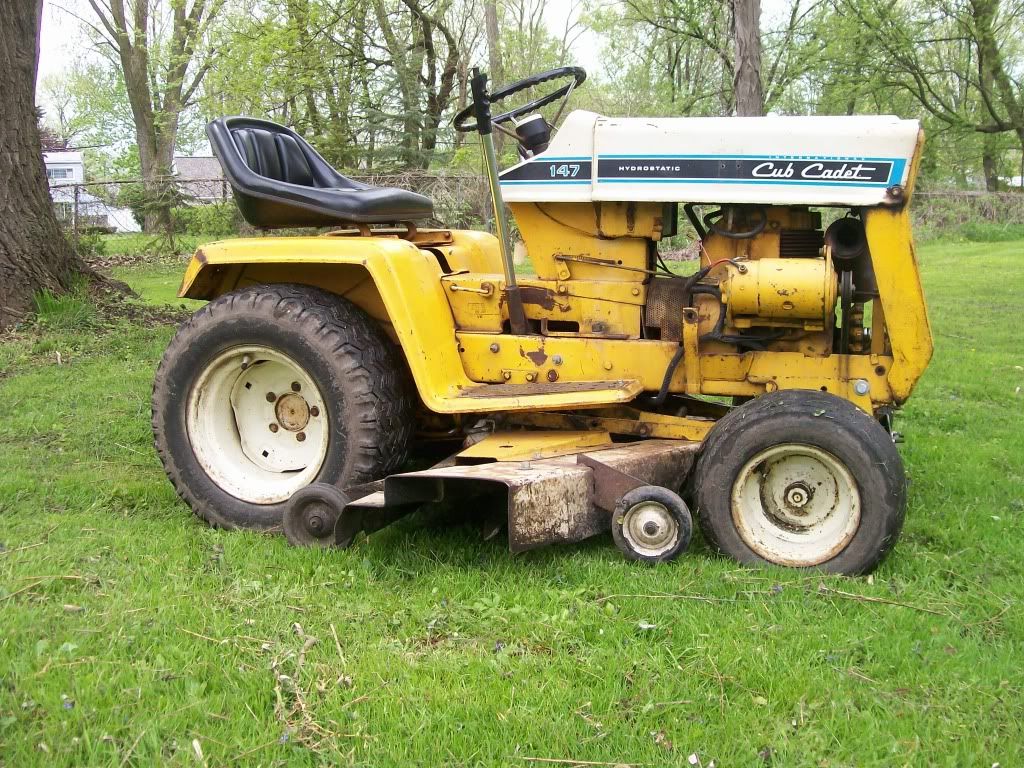

Last month I found an ad on my local craigslist advertising a 1970s Cub Cadet Tractor. Upon further inspection, it turned out to be a 147, in somewhat decent shape. When I went to look at it, he told me the obvious; needed a new front tire as the current one was split like a hot dog, the deck needed welding, and the front PTO had exploded and he didn't know how to fix it.
I went back the next day and picked it up for 250. Immediately I was impressed and it brought back serious memories of the 125. I knew I was going to love owning it.
Here it is the day I brought it home.

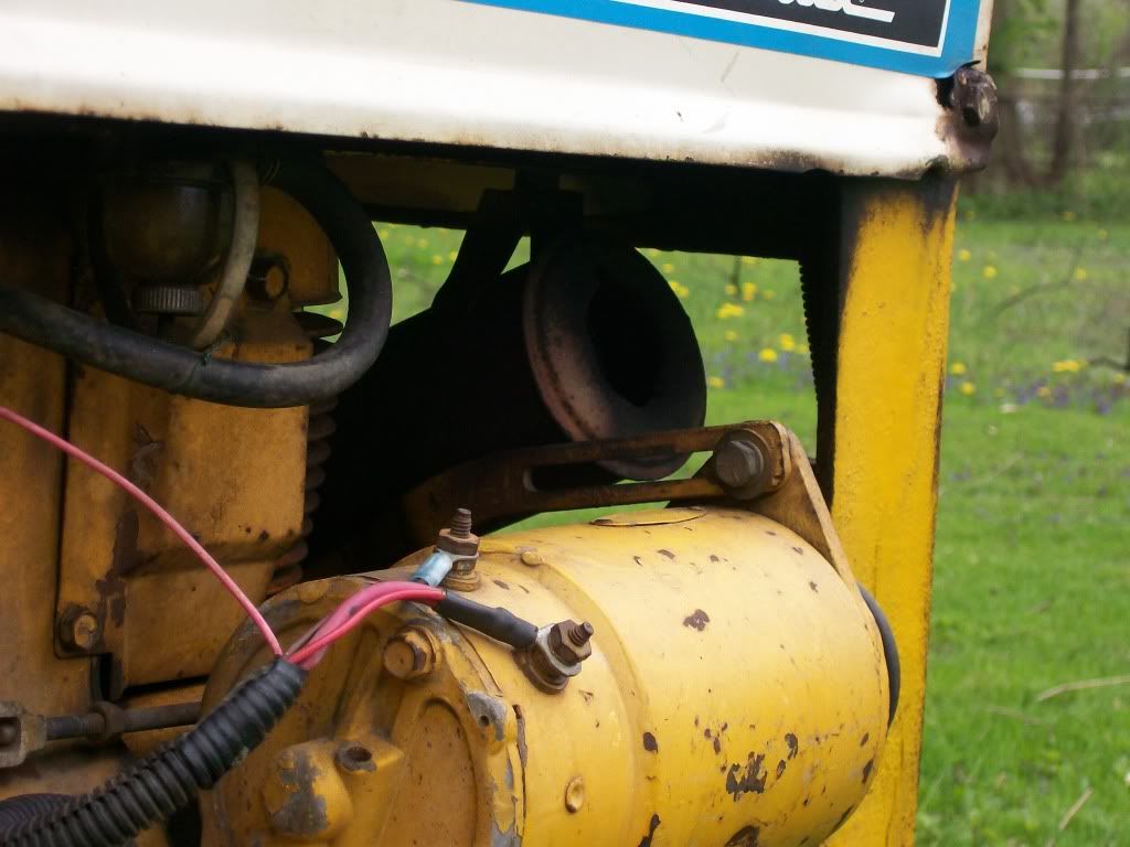

The coil was mounted too high. Upon further research, I found out that the current engine in it is from a 149, even though it is a 14 HP K321. I dropped the coil, routed the wire around the sediment bowl, and it works, and I'm pleased with the way it looks. The ig. wire is now on top of the fuel line and not under it.
What also led me to believe the motor is a replacement is the way the PO did the wiring.
Some day I'm going to fix it and route it back under the engine like it should be, but for now, I don't care as long as it works. It also does not have a plug for the electric lift even though the switch is there on the dash. I also installed a new used muffler with a tailpipe that works must better.

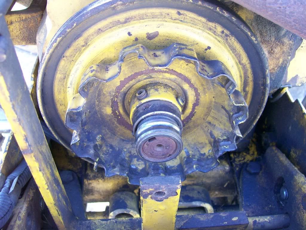

I also had to wire the back lights. This was simple; run wiring as the lights were there, in tact and the bulbs were even good. As far as the PTO goes, basically what had happened was the PO had run the fiber wear button completely off and the bearing had exploded, so the throw out levers were shot, wear button was severely worn, and the fiber pressure plate w/ the lugs was also gone. A rebuild of the PTO by my trusted mechanic, removal and install of the new bearing by yours truly, and then final install of the PTO when it was mailed to me and it started working again.
