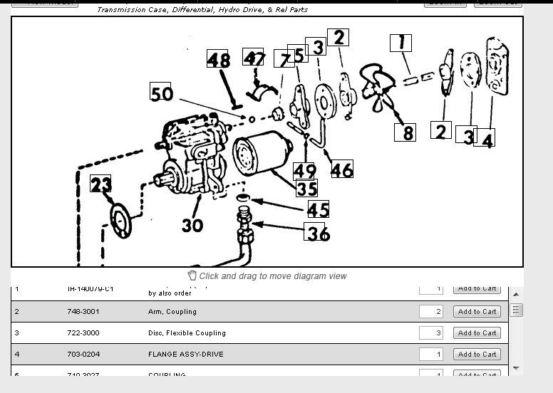

Had to replace a crank seal in the k301. While I have the engine out, I'm replacing the flex joints on the drive shaft, iso mounts and doing the engine cradle mod. When I took the shaft out, the bushing for the drive shaft at the engine end fell and was laying loose in the housing. What holds the bushing in place? I can't find a good picture to see how all this goes together. There was a ball at the hydro end. Is there supposed to be a ball at the engine end, too? I want to fix it the way it's supposed to be. Sorry I don't have pictures, the grass is growing fast and I need to get this back together ASAP! Thanks for any help.

The bushing ball might need to be replaced. They do wear out so you'll have to check for wear. There is only the ball on the transmission side of the drive shaft.

My concern is at the engine side of the drive shaft. When I took the drive shaft out the bushing fell between the housing and the flywheel. It looks like something is missing. What holds the bushing in place? I realize the drive shaft does, but there is too much room behind the bushing. It looks like there should be something between the bushing and engine. There's nothing to keep the bushing against the housing where the coupler attaches.

You need #4 in the pic below, I had to replace the one on my 1250.
#50 is the ball bearing that is placed at the transmission side.
Cubcadet link:
http://www.cubcadet.com/webapp/wcs/s...A/040019100014

That's what I wondered. Thank you very much! Now to find it!

This is what I was talking about. What keeps this bushing in place?
Old 04-24-2012, 10:00 PM
It's worn out and has fallen out. The new one will be held in place correctly. Looks just like the one I had.
