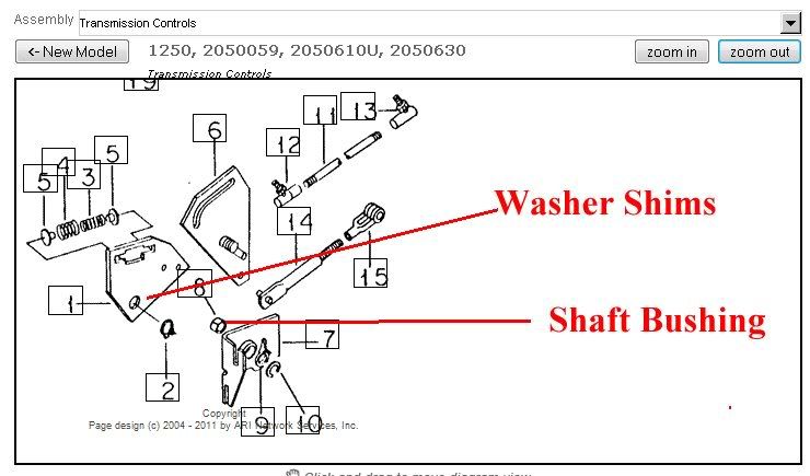

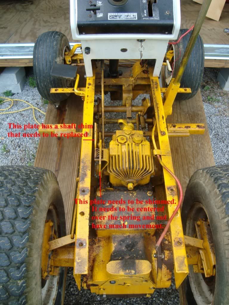

I know everyone spent time helping me with the trunion repair, but I don't think I went far enough with it. I have read on here about putting shims in between different plates to tighten things back up. Are these just washers or actual shim type stock. Would some one that has shimmed theirs up let me know what they did and where they may be bought at, or maybe show me some pics of what they shimmed. Thanks
Old 12-08-2011, 07:36 PM
The shim washers can be purchased from McMaster Carr.

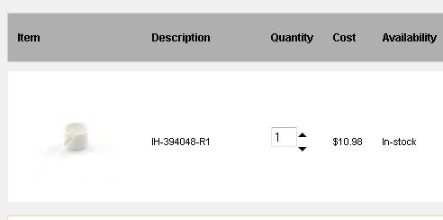

The Shaft bushing is available from Cub Cadet.
.005 shims should be all you need.
Shaft Bushing:
