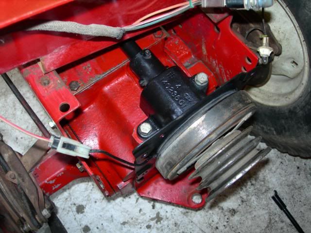

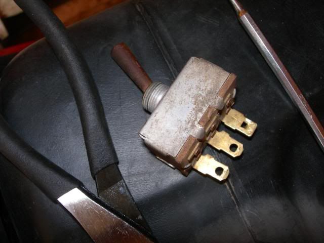

If you search "Wow, that was fast!" you'll find my thread on the installation of my 3 point and rear pto. Yes, 14 is the rear pto, it runs off a separate switch. Here's a few pic's otherwise.
PTO Switch and wiring

Curious the PTO does not go into the rear end like other tractors it runs off of the Hydro? can this be transferred to a 782D?

The rear cover needs to go with the pto assembly. You will need to find out if it is a cast iron rear or aluminum rear in his machine. Or if you can find one for sale you can let his on the machine and not have to drain his hydro fluid.
Here is an aluminum rear cover.
Here are the pulleys, cover, shaft and clutch
The bearing assembly.
Here is the drive shaft from the hydro output to the clutch.
Pics are a help but go to the parts lookup and get a breakdown of the "433 rear pto" it shows everything needed. I don't see the manual for the 433 installation on here but maybe someone can post that up too. It has a list of everything too.
