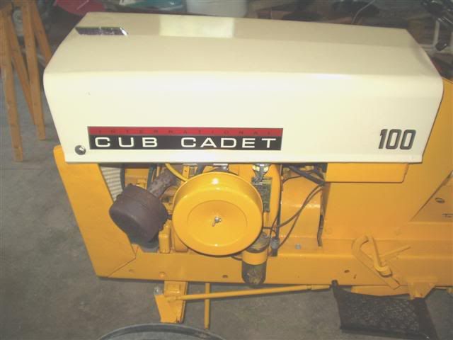

This is the exhaust system I have on my 100.
This is a factory set up. You should be able to find parts.
The smaller diameter exhaust will create more heat. Excess heat is destroys a motor.

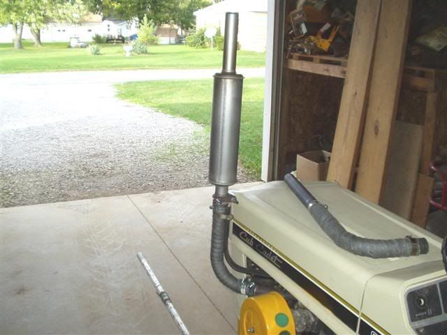

My Son has this muffler on his 86.
The muffler is off a Cub tractor. We have an extra brace on it.
The wrap around the elbow is a product called header wrap.
It keeps the heat in. We were afraid the heat would ruin the decal on the side of the tractor. We haven't had any problems in the last 2 years.
