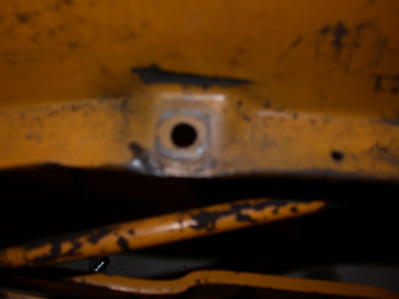

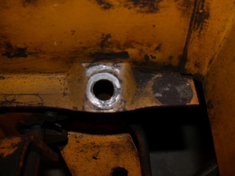

I posted pics earlier of the messed-up ISO mount holes on the rails. I have repaired them to some degree, but need to do some grinding and re-welding. I'm just getting used to this new wire welder.
Tonight, I was poking around and realized that the front left ISO mount hole on the frame was a big mess as well. What's supposed to be a hole for a 3/8 bolt to pass through, could probably pass a 1/2" bolt.
This is a little more difficult than fixing the engine rail holes. Maybe drill it out and weld in an insert? Issues with centering, etc here...
Here's the bad hole:
and a good one for comparison:

Someone here must have fixed this frame hole problem before, I'm looking for ideas.
I've considered welding in a heavy-duty washer to provide the new hole, but if I put it on the bottom I may have clearance issues with the bolt head and the mule release. And if I put it on the top I mess with the engine leveling.
Drilling it out and welding a sleeve in presents a lot of challenges for hole centering. Maybe I just weld the whole thing shut, grind it smooth, and drill a new hole?

One washer height won't hurt the engine or driveline any. It probably ran on bad ISO mounts for 15 years, I'm sure one washer height at one corner won't make too much of a difference. Just tighten that corner down a bit more. I highly doubt a washer on the bottom will make clearance issues with the mule drive, I think there is a fair bit of space there. Looking forward to pics!!
