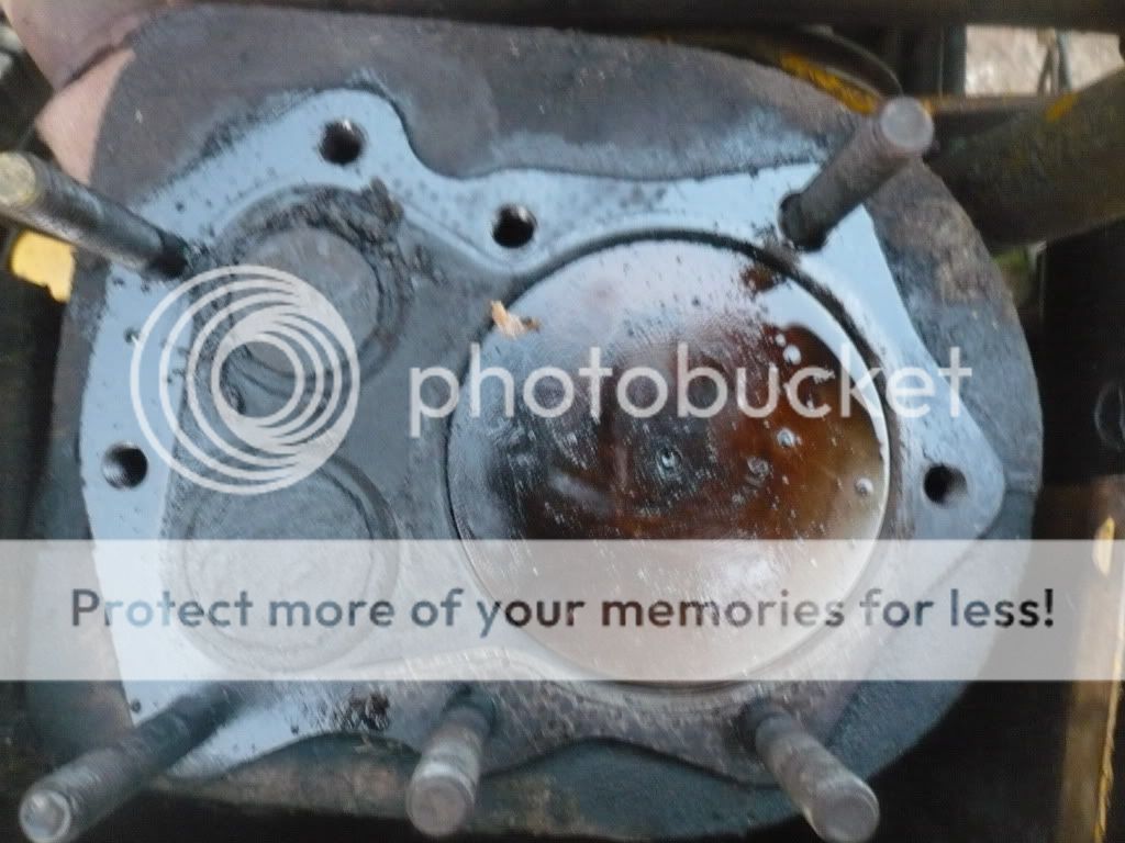

started work late but got the head pulled.
not a bad job at all. ill have to cover it up tonight. but im sure it'll be fine with the amount of oil on there.
couldnt find the leak in the gas tank???
may have to wait till monday and take it somewhere and have them pressure test it to find leaks.
the gasket wasnt in that bad of shape. actually looked new? maybe the didnt torque them down right.... not sure..
anyway heres the head
lotta build up at the valves and a decent amount of oil on the piston... rings failing me possibly?
buildup that i chipped off near the valve.
