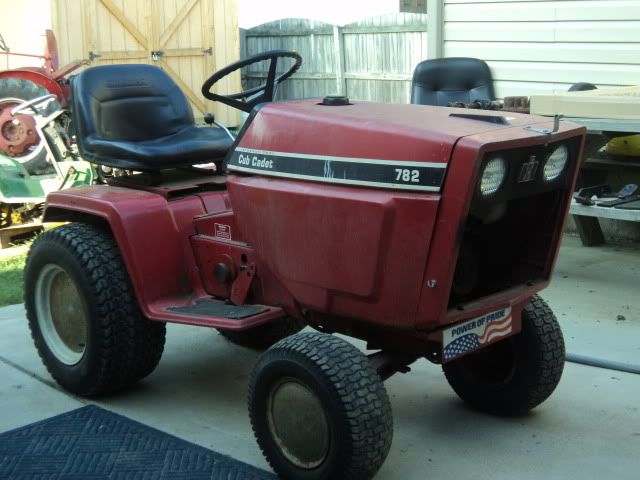

I have a 782 with kohler KT17 baiscly it runs Great has no mower Deck and when i throw the PTO Switch she cuts off put switch to off position she runs fine Seeing how i work at aamco from 8am to 5:30pm sell stuff on Ebay the project has been on the back burner well if anyone can point me in the right direction i would appericate it
