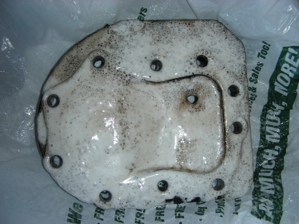

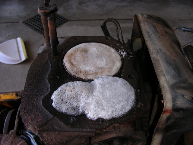

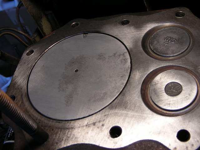

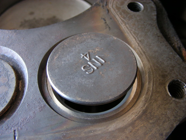

Got a few hours in on the 1650 today. First I used the oven cleaner on the top of the piston, the valves, and the head:
Cleaning the top if the valves was a lot easier than getting to the underside of them. I soaked a cloth with oven cleaner, wrapped it around the underside, and let it sit for a while, then buffed the underside with the rag.

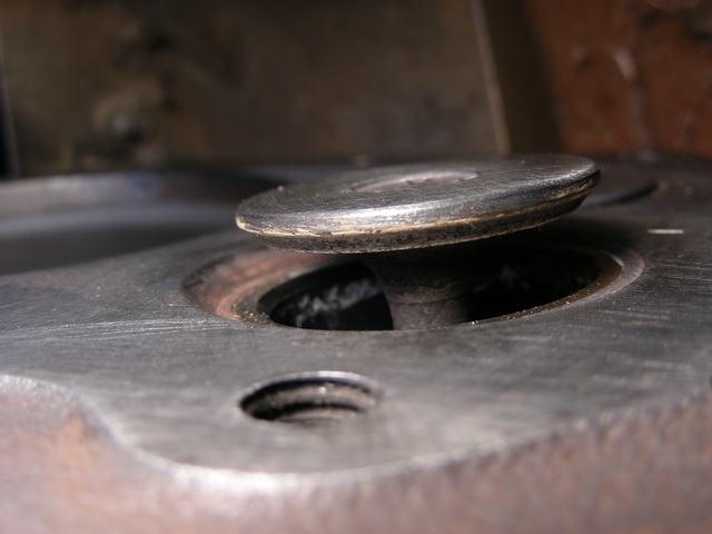

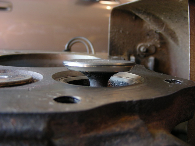

Seats are looking much better:
Here's the topside as I stand. I think that's going to be good enough:
Although the underside of the exhaust valve isn't going to come as clean as the intake valve. I'm wondering if I should just pull them and give them a more thorough cleaning (?)

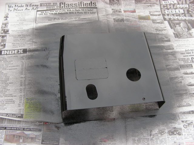

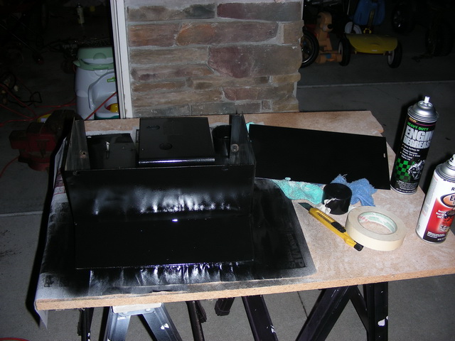

I felt in the mood to do a little painting, so I figured the engine tins were a good candidate. Scrubbed them all down in the laundry sink, sanded them with a couple high-grit sandpapers, and shot them with Rustoleum gloss black engine paint;

Use care when using the oven cleaner....it likes to eat paint just as much as it does carbon deposits! It did a great job cleaning your top end and valves!

If you are in there that far I would get some valve grinding compound and grind both valves so you for sure don't have to get in there again. You will also have to re-adjust the valves again after that.
That spot on the piston isn't good, but as long as it doesn't go all the way down to the ring I wouldn't worry too much at the moment. I would put some oil between the piston and bore to make sure any oven cleaner that got down there doesn't cause any problems. I would also recommend cleaning the cooling fins on the cylinder after you get the engine bolted back together; I see a bunch of crap in the fins in the pics of your valve adjustments. If you haven't already, I'd remove the flywheel shroud and clean the fins on that side, and remove any grass/mouse debris that might be in there.
