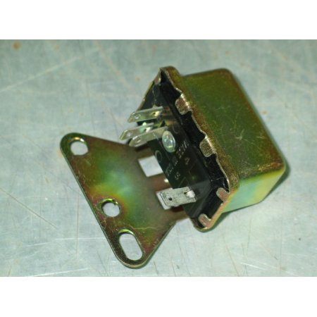

Originally Posted by beancent View Post
I would guess that your relay looks like a typical relay, black plastic outside about 1 1/4 square inches with 5 or 6 spade terminals on the bottom to connect your wires to. Do you have a ohm meter to do your testing with? Not really sure where they placed the pto relay on your 1872.
This is what I have on my cubby. Old school, nothing plastic
https://www.ihccw.com/image/cache/ca..._1-450x450.JPG
No safety's, nothing. all bypassed heh.

Those good metal cased HD relays were sourced from Delco Remy, and were used on GM vehicles for A/C high speed blower motor fan relays and headlight door relays on hideaway headlight cars.
They don't fail often. Typically, either the seat switch or reverse switch/circuits are to blame for the issue you are experiencing.

Were you able to do any testing at that pto relay to make sure you have the 12 volts at both the brown and white wires?
I have +12 on the white, nothing on the brown.
