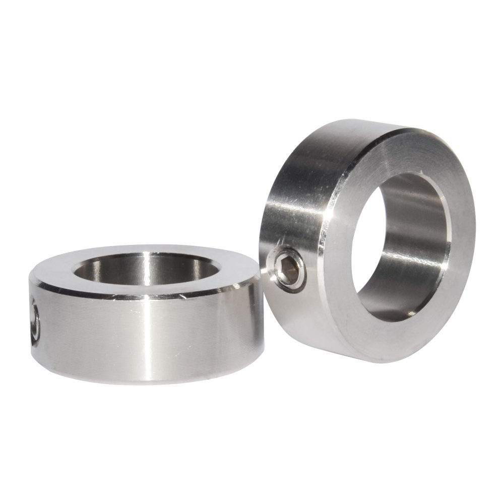

On my first Cub,, I had similar slop,,
It ended up being the through hole in Items 6 and 7 of the previous image.
I welded a 1/2" bore locking collar on Items 6 and 7,, at the top, and the bottom.
Then, I had to get bolts that were one inch longer (the collars were 1/2" thick)
The bolts were tightened, and the slop was gone,, forever,,,

The locking collar looked like this,,,

Originally Posted by clay1811/44c View Post
Before you go cutting and welding on things. Take it apart and see what is going on. My first 1811 had slop in the front also. I found the bolt turning in the bushing, just needed tightening. The bushing should turn in the housing where the grease is. see #8 and #9
Thank you for taking the time to dig out the graphic...
So ...this is not exactly the same, but similar...the holes in #7 on your drawings for bolt (#9) to pass through have a lot of wear...everything else is nice and snug...so my thoughts are to just "cover those holes with 1/2 inch washers..and weld them to that item # 7 ...essentially providing new holes that would be tighter....I have also played with the idea of using nuts, drilling out the threads, and then grinding them down a little bit flatter and welding them on....these are just ideas and ...you are right...I am not going to just start attaching things that may or may not work
You posted this as I was writing up the post I just put up...yes that is the idea...do you know where you got them?...and thank you

Grainger and Fastenal are your friends! :-)
I did find them at McmMaster...less than 2 dollars each for teh zinc coated steel...is that what you used ...or did you use stainless?...not sure what rods to use to weld if I were to use the stainless
