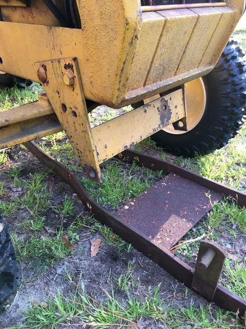

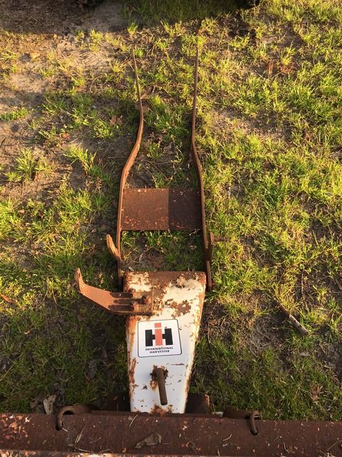

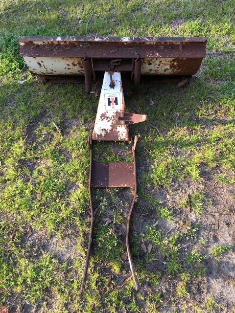

Picked up this blade and was told it was for a narrow frame.
I'm having some difficulty installing. Does this look like a narrow frame plow? I see most are bolt on where this has extensions with studs for cotter keys. Maybe the subframe is home built?

That is a Sub-Frame for a Wide Frame tractor.
Narrow Frame Sub-Frames have straight arms going back.

Yup, another vote for incorrect subframe for your tractor.

I do believe that if you remove the arms on the subframe and re-weld them on opposite sides that it will work for a narrow frame with QA (quick attach), but that is more work than what it is worth. All you really need for your set up is a bolt on subframe. Some people might trade you for your subframe that you have there or you might be able to find one for purchase.
