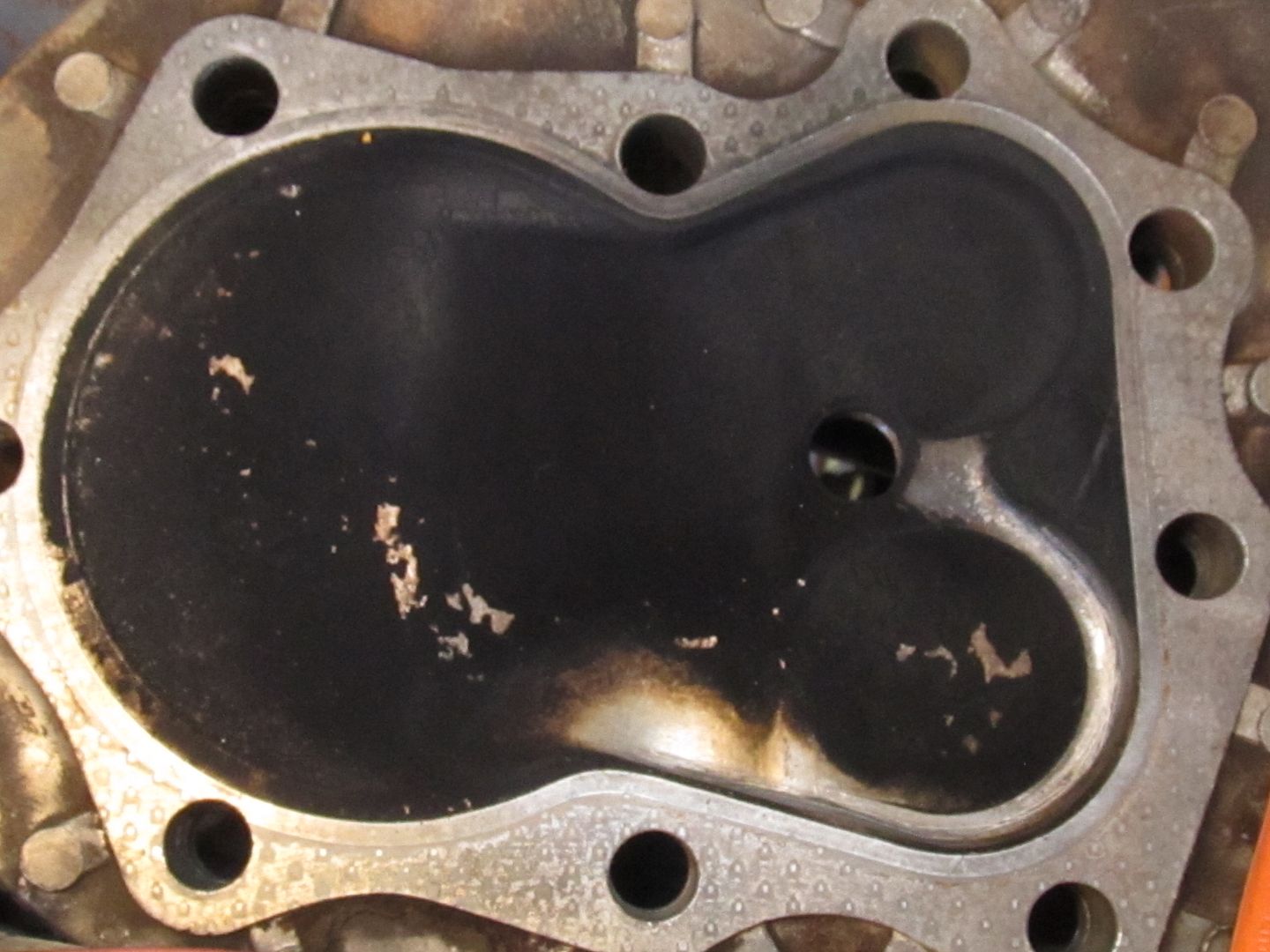

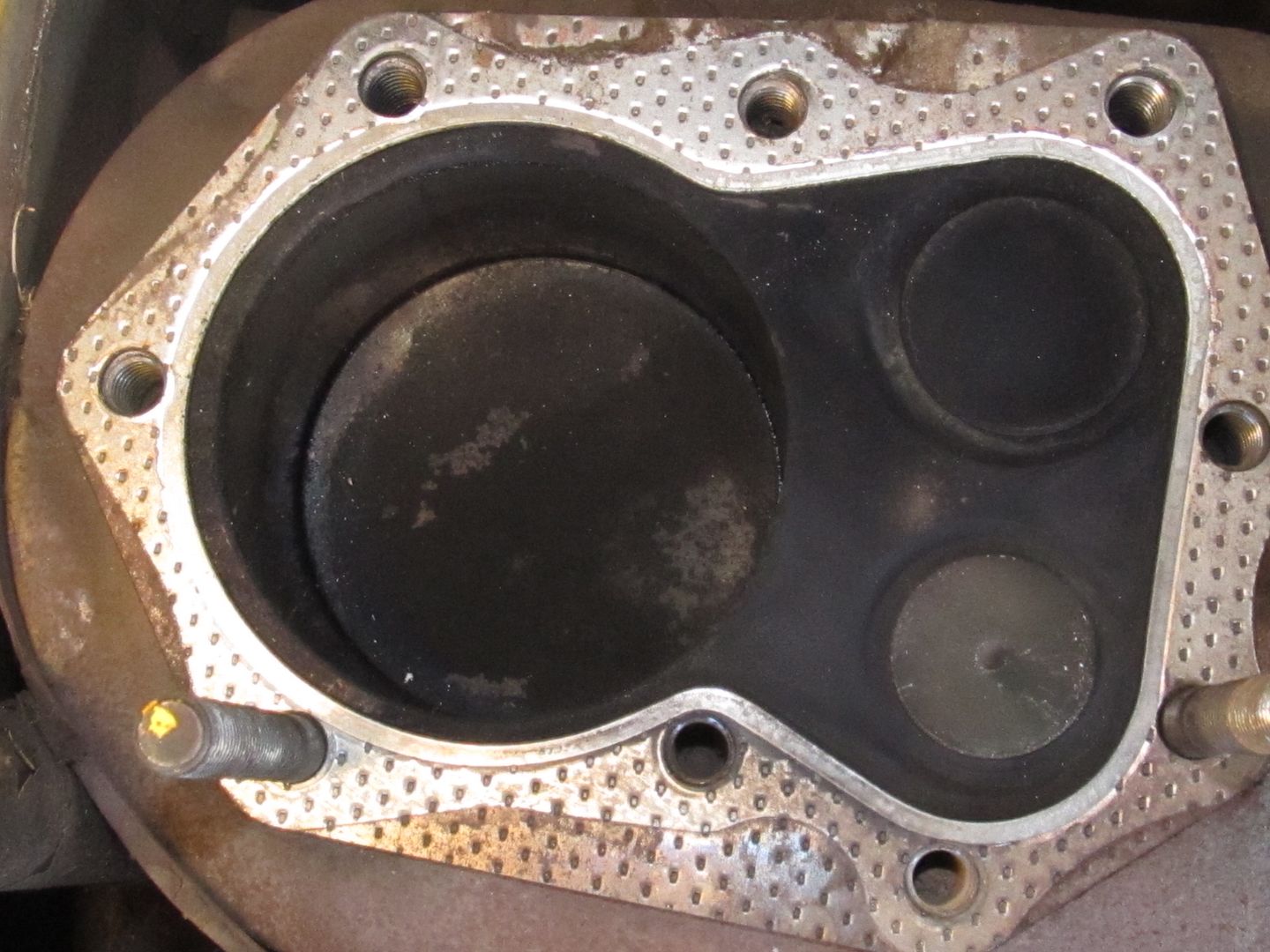

Figured I'm overdue for my 500 mile cylinder head cleaning and you wanted pictures...see anything abnormal?

So what kind of clearances do you have on the valves at TDC?
they seem to be pretty much spot-on where they should be, .008 and .018 for intake/exhaust. I do notice a "catch" as I slide the feeler through the intake side though, like there's a high spot in there. Not sure what to do with that, if anything.Its possible that high spot is keeping the valve more closed than it should be? The adjuster seems quite tight and I'm reluctant to overpower it. Wondering if I should adjust for the high spot or try to knock it down somehow.
It didn't seem abnormally cruddy nor did I notice anything that might cause sticking around the valve seats themselves, though I have limited experience with which to judge "normal".

Could be an optical illusion to me but doesn't the exhaust valve spring (on the left) look like it's broken? might just be deposits

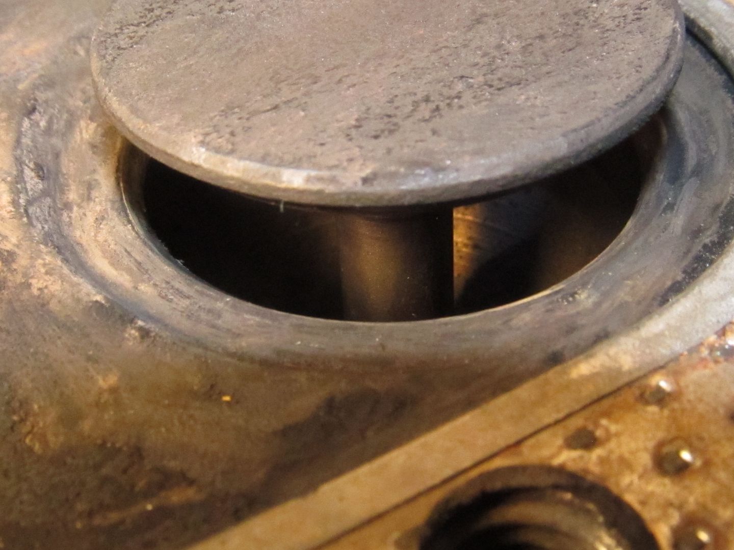

With the intake valve up what does the valve seat and valve sealing area look like? Pitted or scored up real bad? If so time to tear it down and rebuild.
It didnt look bad to my eye. Here's a pic after I cleaned it up a little. Hard to see the sealing surface of the valve real good but it feels pretty smooth.

Looks like it has seen better days to me. It's hard to tell from the pics but it looks like there is a few divots around the sealing area. I'm not seeing the sealing ring around the valve seat. I just rebuilt a k301 last year for a friend of mine and it looked the same way. Same symptoms as you are having. I would say a rebuild is in the near future.
