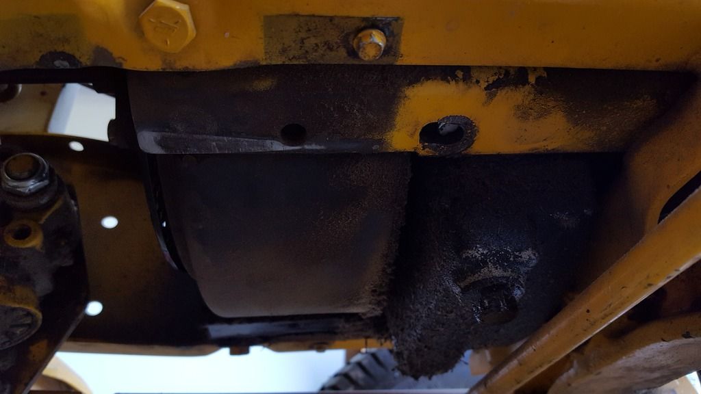

It looks like there is a missing bolt here. Upon closer inspection, there is no hole to simply replace the bolt, as if the bolt head had sheared off at some point. I cant imagine what would have made that happen.
I have a terrible video I made of it running that I will post later today. Thanks everyone for the replies so far.

Put the flashlight to it, and the bolt head is sheared off. Should be fun to get that out.
Old 06-13-2016, 12:22 AM
bocephus1991's Avatar
Posts: 2,633
Pull the engine and remove tha pan, easier than fighting with it.
