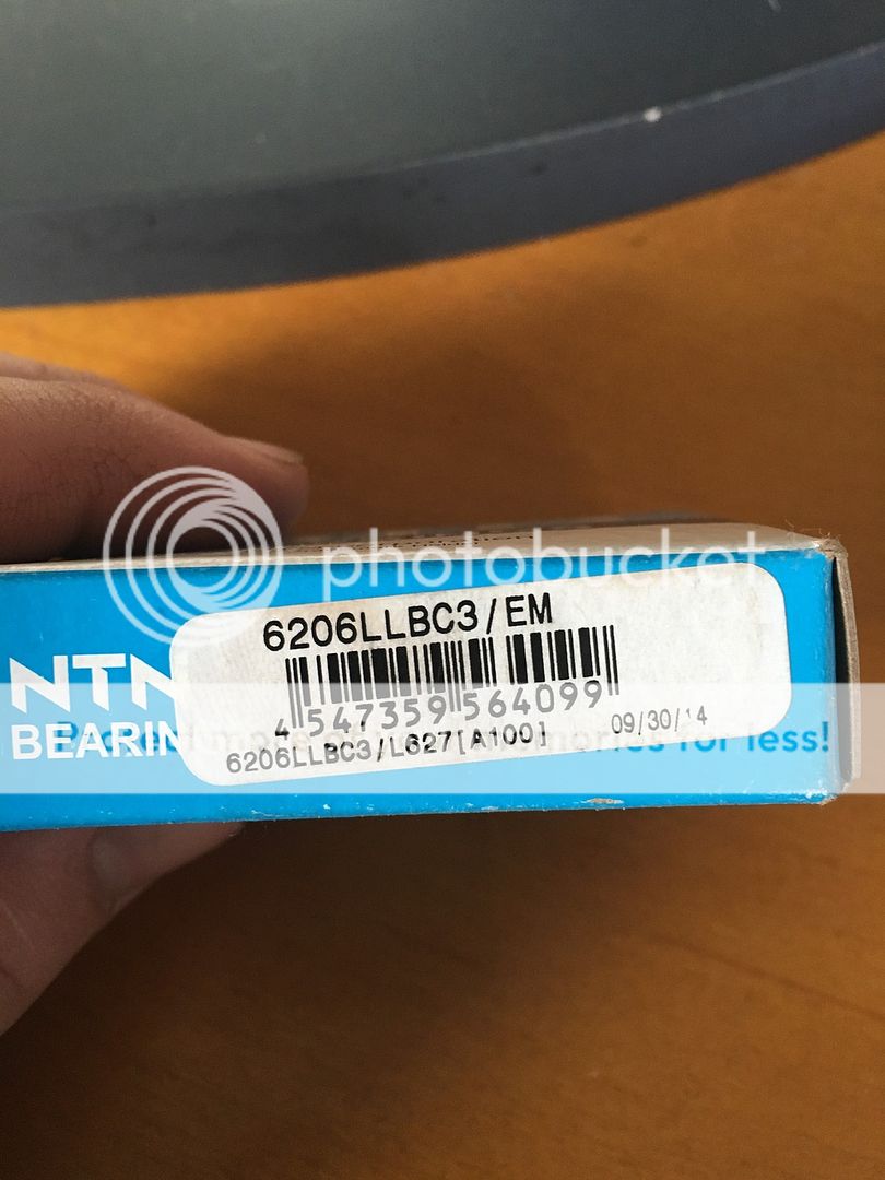

Does anyone know what the bearing number is on the front PTO clutch on a 2072 or 2082?

I think guys here have been changing the bearings out. I don't believe its something you buy from Cadet, have to go to a parts store (Napa) or bearing supplier. Search the forums for electric clutch rebuilds, don't think anything is special about the ones on Supers. There should be a number on the old bearing, probably can see it without even removing it.The one on my 2072 is beginning to get noisy at times.

Here Ya go.
http://www.onlycubcadets.net/forum/s...highlight=6206

I replaced the bearing in my 2082 (late serial #) last spring and this is the bearing I used. I picked it up from my local electric motor shop for about $15. Make sure you've got a press to get the old one out and get the new one pressed back in all the way. I didn't have mine pressed in all the way at first and it gave me fits.

A press will work but I've only ever used a large socket. Hold the pto in your hand and hit the socket to drive the bearing out, clean the area where the new bearing goes, start the new bearing and put some red Loctite on it and drive it down until it hits the stops near the bottom. I've used the old bearing on top of the new to hammer it into place to keep from damaging the new bearing. Good luck and let us know how it goes.
