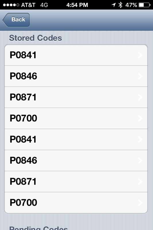

Unfortunately, this is what has been occupying most of my time;
Those are a list of the codes the truck was throwing, when the Allison transmission decided it wanted to play "shift range inhibited". Did some tail chasing, but my fingers are crossed that I have it sorted out now.

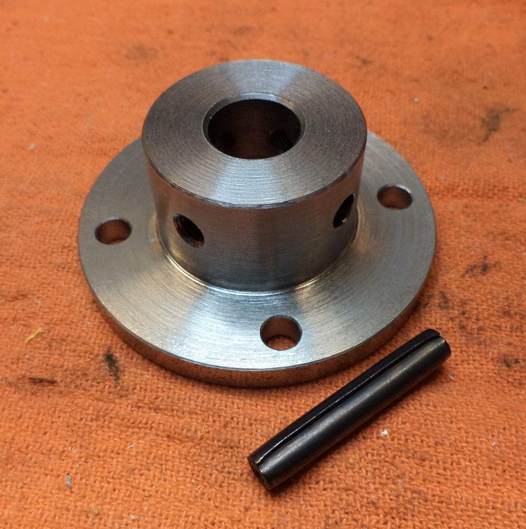

The adapter in the pic won't work on a 1772. That is for the pumps with the 5/8" round shaft, you need the one with the 5/8" nine spline like the one in this pic.
Sam,
I need the overall length for that adapter with the spline welded in.
MWShaw
I'll order splined couplers and get one to you asap.
Sorry about the mix up.
Jeff
