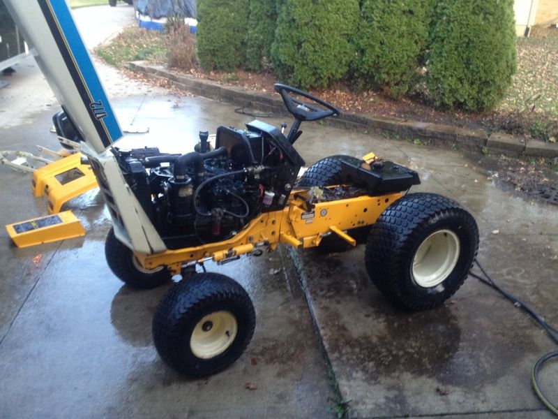

Plan to pull the seat pan off tonight, poer wash the crud off, try and pin point where the hydro is leaking from.

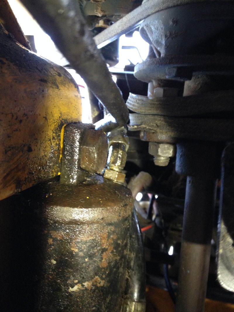

Well, there's good news and bad news. The hydro leak is fixed. The front rag joint on the drive shaft, had loosened up just enough to hit the hydro line that feeds the lift cylinder. The fitting came loose and was leaking a good amount of HyTran.
I was able to tigthen up the rag joint and the hydro line. No more leaks. Pictures were hard to take but this is as good as I could get;
Now for the bad news;

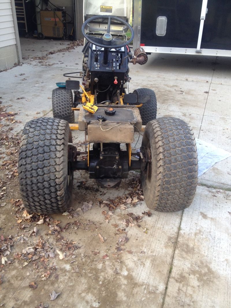

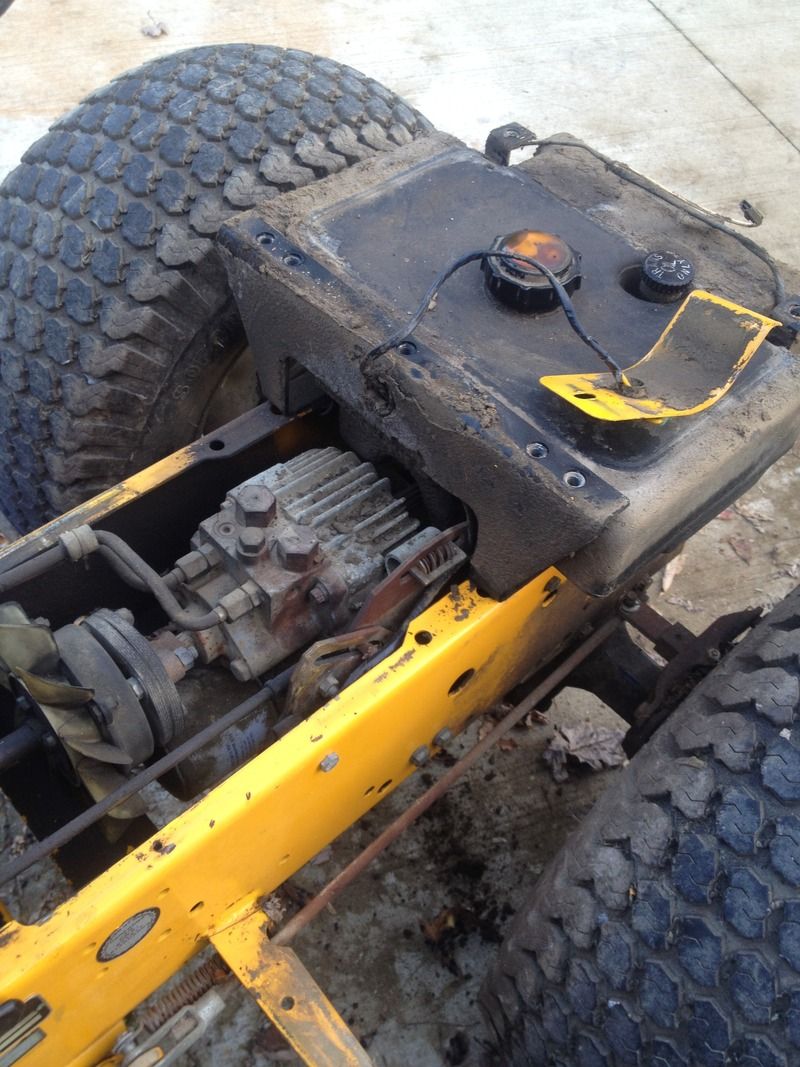

Rear axle housing is broken. It is not leaking any fluid and none of the bolts are loose or stripped. It's just cracked. I wonder if Vince ever used that one I gave him from the 2072 I parted out.

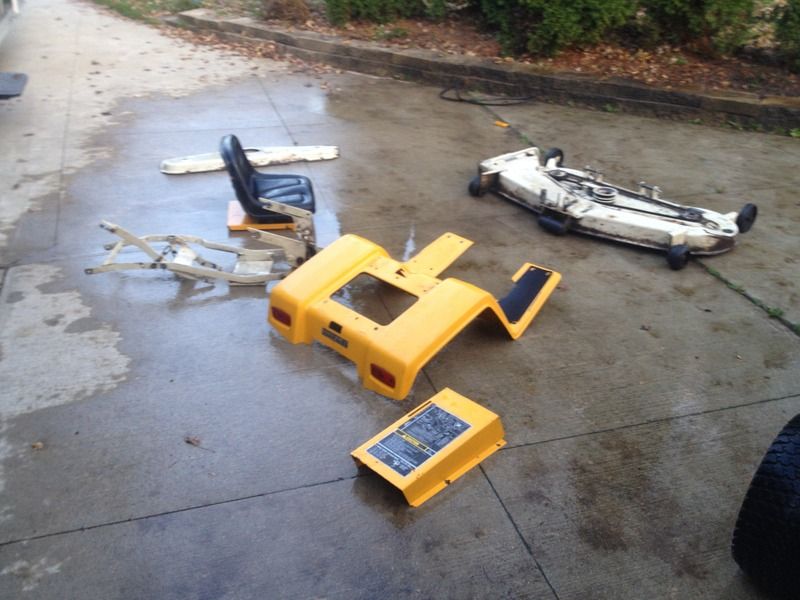

But we spent some quality time with the power washer, it's a good solid tractor. I like it a lot.

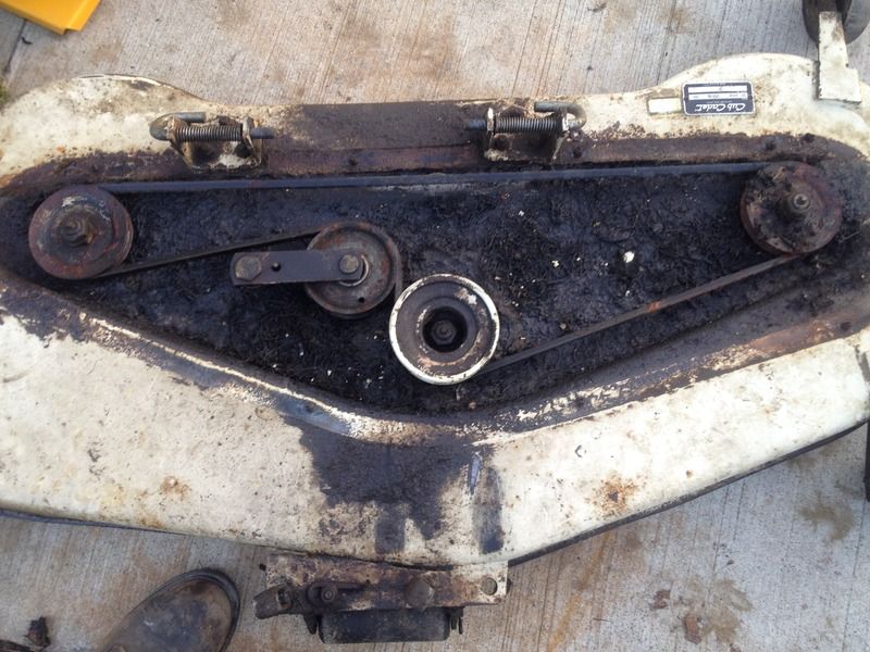

It had been leaking HyTran into the mower deck for a while;
