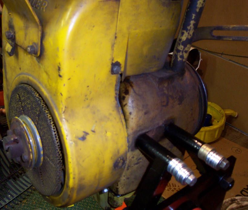

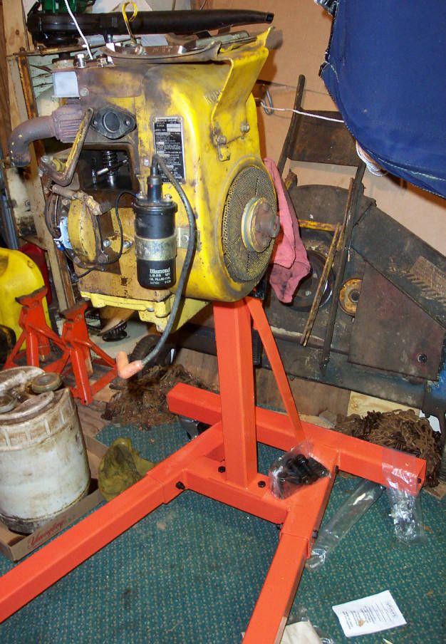

Old 10-20-2015, 08:54 PM
Used the starter generator bracket holes

Thanks for the photos, that is what I was looking for. Had not looked at the S/G bolts before , but that will work great.
Joe

Yeah, that's what I did a few years back, also. Same model Harbor Freight engine stand also. It worked out just fine.
