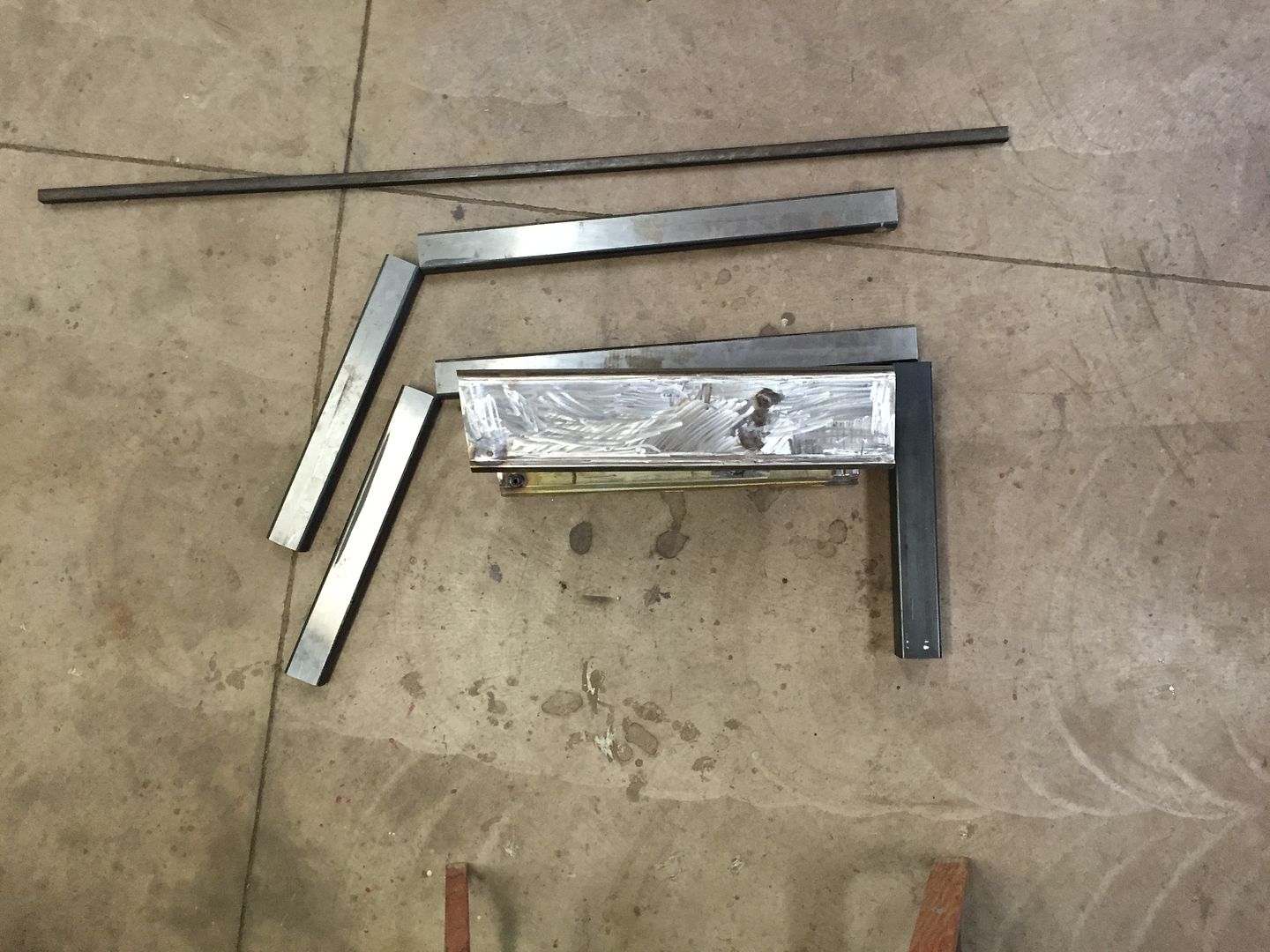

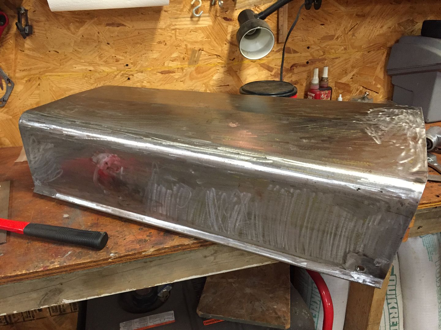

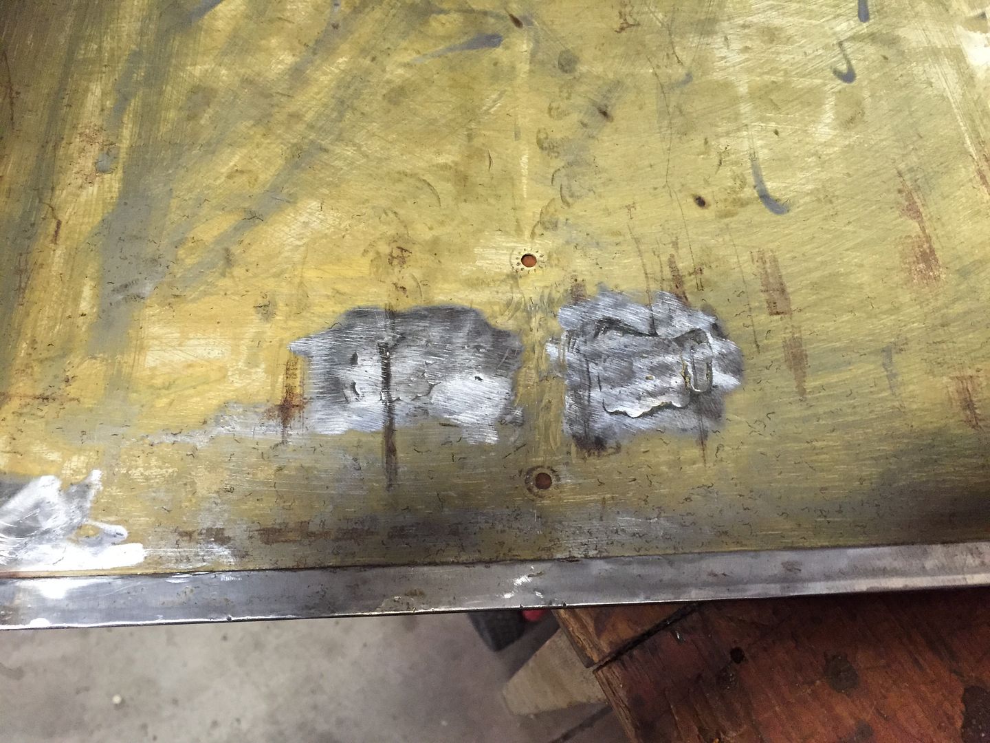

The hood is ready for body filler finally. I welded shut several extra holes, made and welded in a new brace, and built up where the hood was nearly worn thru where it rests on the top of the grill casting.

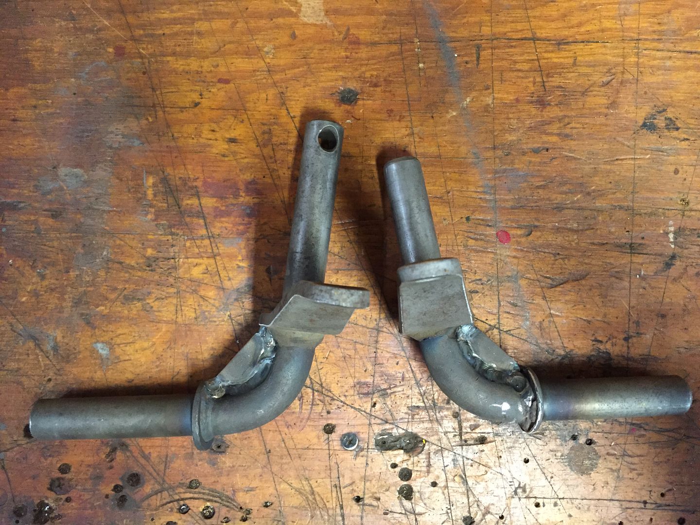

The spindles got braces welded into the corners to prevent them from bending.

Oh, and I'll just leave this here.
  #59
Old 10-03-2015, 08:20 PM
Ahhhh, now I see. Spindles with gussets......it all makes sense now. Sweet can't wait to see the "cough" come together as well.
